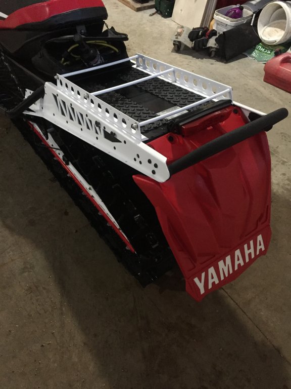

Saw this first hand as diesel rode with our group Friday. Crazy that a little bit of weight could do this. Shocked the crap out of me!
So, I will not be pushing down on my rear grab bar. Mine is an XTX but still don't need this happening.

This is what you get when trying to make sleds too light. Remember, anything behind that rear suspension mounting bolt is not structural, its basically a fender just along for the ride. It seems that bracing may be needed when loading these things with equipment.

did the back end get sucked down (strapped down) on the trailer for transport?plus the weight of a gas can? I know I wont mount a gas can now.

The sled was hauled on a sled bed and I strap the back over the rails so no it wasn't sucked down. But that would easily bend these things. My dealer submitted a claim to Yamaha but they don't think it's going to be covered they said they would straighten and install my bumper at its first oil change if it gets denied.did the back end get sucked down (strapped down) on the trailer for transport?plus the weight of a gas can? I know I wont mount a gas can now.

Looks good!!

What brand is the bumper?

Arctic cat accessoryWhat brand is the bumper?

Thanks for sharing it definitely going to do this with mine now

View attachment 124539 View attachment 124538 here is a couple of pics of the new bumper this thing is rock solid now
does this use any of the stock holes or is there a lot of new drilling required?
