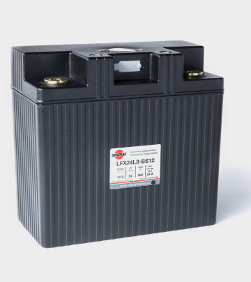

Mike, I see, they offer the Shorai #24. Is there any fitment issues?
Price went up a bit.....$269.
Most lightweights have pads or shims that get used to install. If you shop around on the internet enough you can find most batteries at far lesser costs it seems, all except the EarthX it seems anyway.

Funny I contacted NOCO to see if there was anything that could be done to prevent the cold shutdown in their BMS and they were not even interested in discussing it. Just that it cant be done. The NOCO is a great battery for summer, I just wouldn't use it in a snowmobile or anything for the cold weather. Thats why I use the Shorai, its proven to me to work well in the cold on the Winder. EarthX would be good too from the sounds of things, just not sure why they are sooooo expensive and you can't get any deals at all on them.
