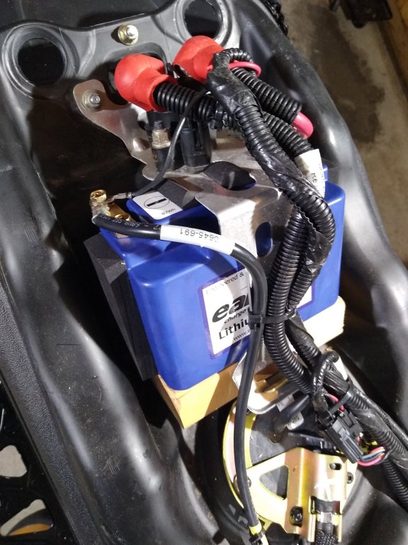

Return fuel line not re-routed?Any questions or concerns?View attachment 173931

I have parts, just haven't did it yet. So, I'll do the harness, re-route & pump at the same time.Return fuel line not re-routed?
