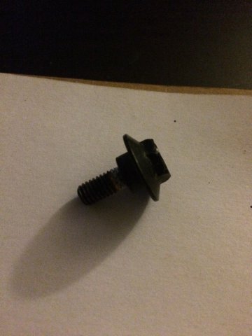

So I took off my nose cone and had to drill out the phillips head screw/bolt. I need to replace them. I found the same bolt on the rear side plastics with a 10mm head. I would rather have the bolt head but I can't find where to buy them. Fastenal could not find anything close. Any suggestions?

Thank you. By chance do you have the number for the bolt in the picture? I believe it holds down the tail light and hold the side plastics to the aliminum exhaust shroud.P/N is 90149-06263-00 for 1 each

Thanks to Pete's post I found it.
90109-06174-00

Yup thats the bolt that holds on the plastic side panel under seat.

Tailight bolt 90109-06043-00

If the bolt has 10 mm head, chances are it's an M6 x 1, unless it's a screw that threads into plastic?
Your local hardware should stock this diameter and thread pitch, it's very common. All you need is to determine the length needed.
