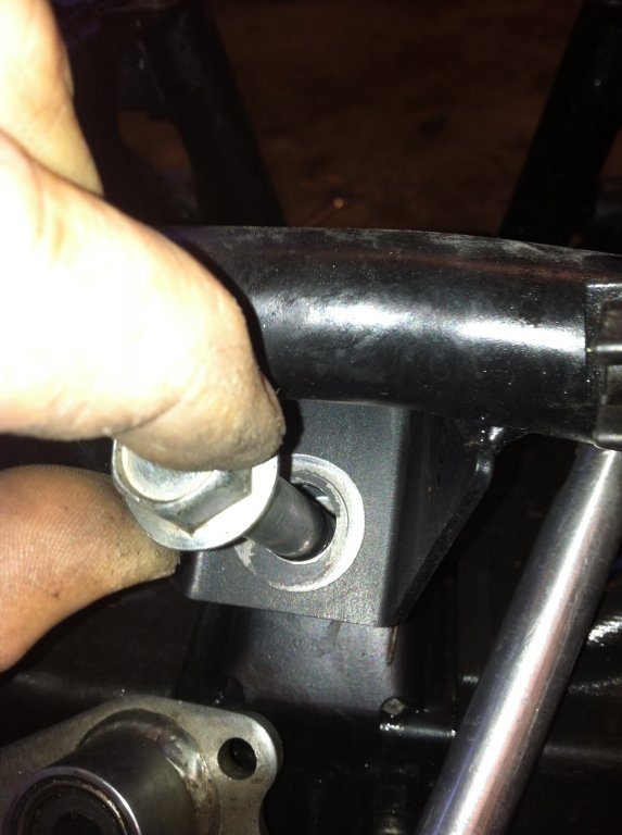

I've repaired a few of theses egged out pivot holes by partially welding them closed and grinding back out to the proper size.

I just got this thing straightened out today. For now, I have some pics to share that show the extent of the hole wear. In the next few days I'll be putting it all back together and will send up some pics of what the repair looks like.
Here's the hole:
And here it is with the bolt in it, just to show how much slop there was. As you can see in Grizz's pics above, the hole diameter should be just big enough for the bolt to pass through.
Here's the hole:

I recently fixed my 08' that I picked up. I welded both the top and bottom holes up and re-drilled them. If I was to do it again I would weld washers in place on each bracket and use a longer bolt. I had to spend a lot of time trying to grind the brackets flat after welding them. And we all know access to work on these brackets even with the subframe stripped down and off the sled is not easy. I assembled the steering assembly pivot bolt with red locktite with hopes of preventing it from loosening up again. G.B.

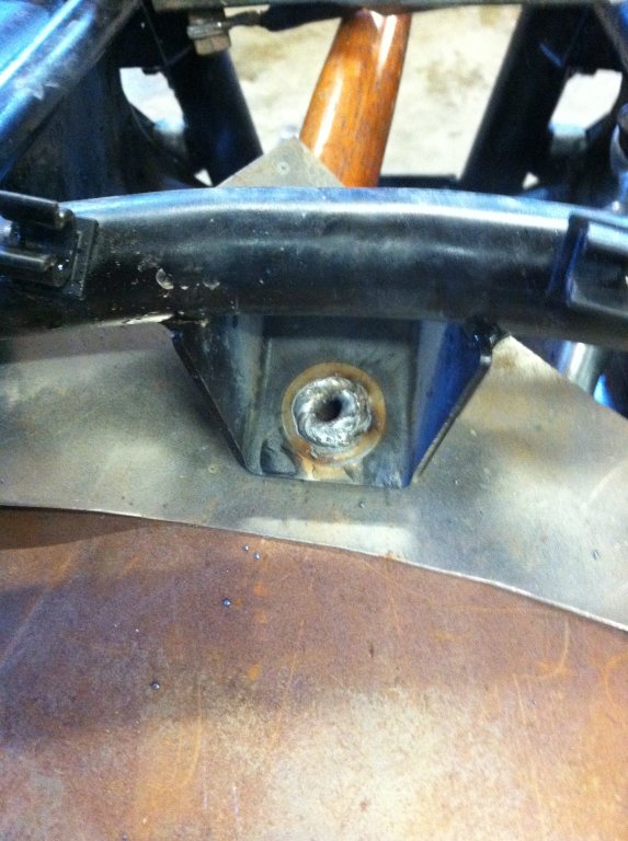

I just referred someone over to this thread, and realized that I never posted a picture of my fix.
You can see a few plates welded in at the top of the bracket:

Yep, that works too. I've welded in washers to thicken up the frame mounts.
Mountaintech
The best fix for this problem is to weld in 12mm collars top and bottom and use a longer 12mm bolt. Even if the bolt ever loosens up there is so much bearing surface in the collars the bores will not wear out.
