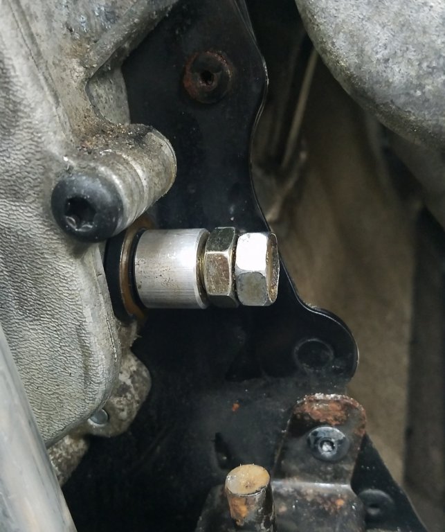

Help! Just took off the muffler to adjust the chain tension. I loosened the jam nut... started turning the tension bolt in by hand, and it doesn't ever stop! It gets all the way in and never hits "bottom." Is my tension roller likely out of place? I have not ever taken the chaincase cover off, but had the dealer change the chaincase oil at 500 miles. I changed the chaincase oil last year by suctioning it out. Sled has about 2000 miles on it, its a 2017 SRViper XTX SE. Still under Y.E.S. so I'm thinking of trying to get it in.... Any other suggestions?

Wheel is probably gone
- 21,908
- 9,498
Here's what I'm looking at...
I would rip into that chain case. There are problems that need to be addressed.

True. I know my 18 winder had both screws just about out last year when we replaced the bushing and welded the screws in. No damage, caught it in time.Wheel is probably gone

Dealer called... chain stretched so much that the tensioner wouldn't reach any more. Wheel and screws intact. Not covered under warranty because chain is supposedly a wear item.
Everybody keep a close eye on your chain tension!

So it just needs a chain?
- 5,722
- 4,313
As per your first post, the sled only has 2000 miles. On a Viper, your chaincase should not need any parts, especially a chain, for a very long time.

Yeah, dealer checked gears, bushings, and roller and said all is good but the chain.So it just needs a chain?

I agree, but that's what's going on. Glad it didn't turn into a grenade on the trail. Maybe it would have been covered if it did though....As per your first post, the sled only has 2000 miles. On a Viper, your chaincase should not need any parts, especially a chain, for a very long time.
I have 15000+ miles on my chain which is same as yours. Plenty of adjustment. Something is not right. But maybe the dealer didnt want to admit just sucking oil out and missing the issue the last time. I would be checking tension myself now though. Back it out. Pull back rubber washer. Screw it in lightly with two fingers till any resistance is felt then back it off 1 1/2 turns. Compare to how it looked before.
