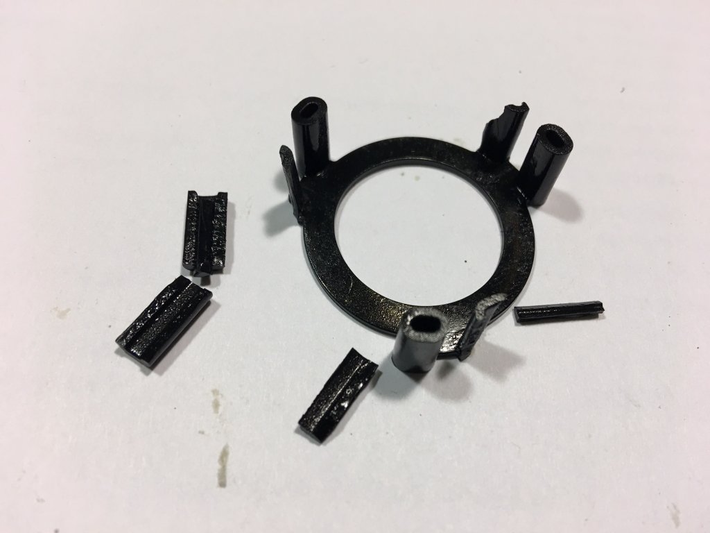

Had the clutch side jack shaft bearing go on my 2015 Viper with only 1500 miles on it. I normally check and repack them but didn't think it needed it with those miles. As long as I had the jack shaft out I also replaced the chain case wobble bearing with a FAG bearing and repacked the lower drive bearing which actually looked fine. Everything looked good in the chain case other than the rubber damper for the reverse gear. The rubber was in pieces so it was replaced but I'm not sure how important that little bit of cushion really is. Maybe solid damper spacers would hold up better.
