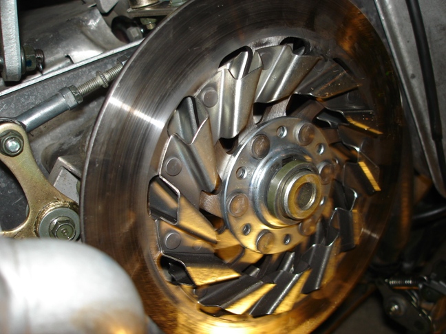

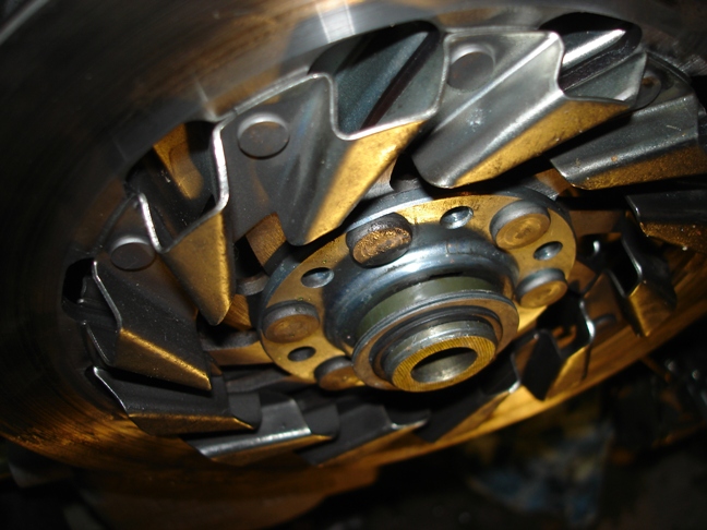

Not sure if I have these shims and spacers in the proper order. Specifically the shim that goes between the locking collar and the cover. I changed the track out in the summer and I seem to be having some leakage on the chaincase cover. Almost seems like it is leaking out from where the jackshaft comes out of the chaincase cover.
Here are some pics.
Here are some pics.
grader
the collar with the set screw goes on first and seals the chaincase. your pictures show a smaller coller on first, and that is where it is leaking.

X2! The dark line you see in the silver collar is where that lip seal is supposed to run.

just reverse the first and second collers and re-assemble. everything else appears correct, just install key in rotor and circlip.

Not sure which one you mean. The narrower collar or spacer is correct on the outside of the disc brake. You just need to switch with the locking collar and wider spacer as mentioned above.

Thanks guys. I got it back together.
I had been looking at the service manual and already had the pic that yox185 posted. It doesn't show a spacer on the outside of the locking collar. It shows a spacer on the inside. The one labeled new.
