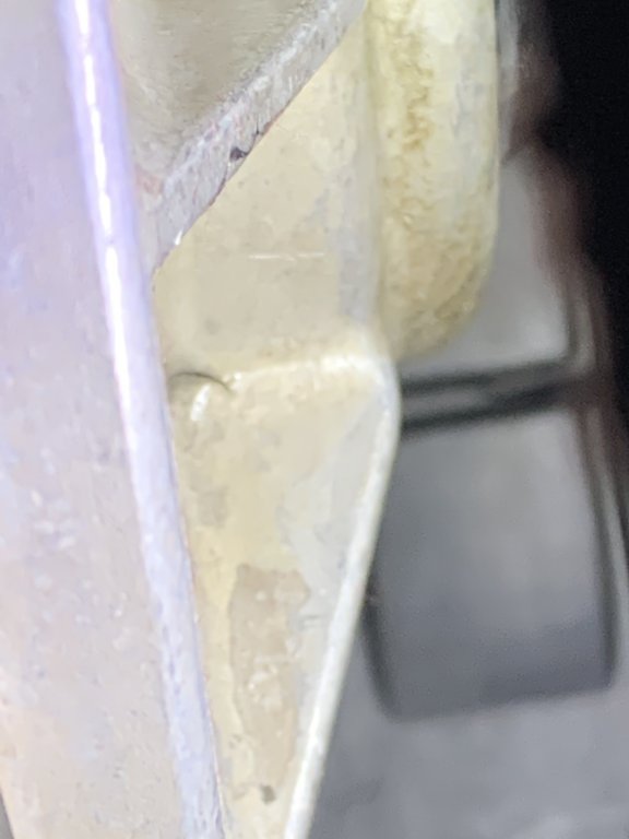

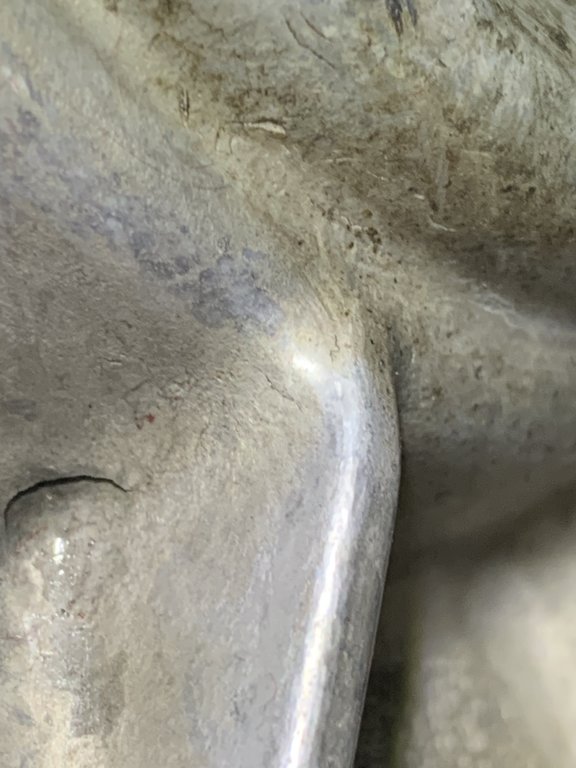

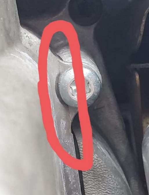

The mentioned seal could be bad. One of the ears that the bolts go through could be cracked. Look lower 3-4 inches of case For a casting imperfection or crack. Look on the inside of tunnel with a very bright light. I found this in pic on a brand new 21 cat I bought last year. Surprise surprise!! Garbage quality control on CAT parts and assembly,

It was the oil tank on this 2020 cat!The mentioned seal could be bad. One of the ears that the bolts go through could be cracked. Look lower 3-4 inches of case For a casting imperfection or crack. Look on the inside of tunnel with a very bright light. I found this in pic on a brand new 21 cat I bought last year. Surprise surprise!! Garbage quality control on CAT parts and assembly, View attachment 162949View attachment 162950View attachment 162951
The guys thos happened to had a little fire after a wot run on a lake. Stock with 1000km
