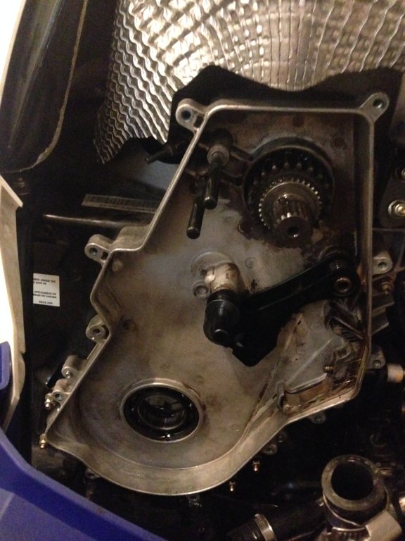

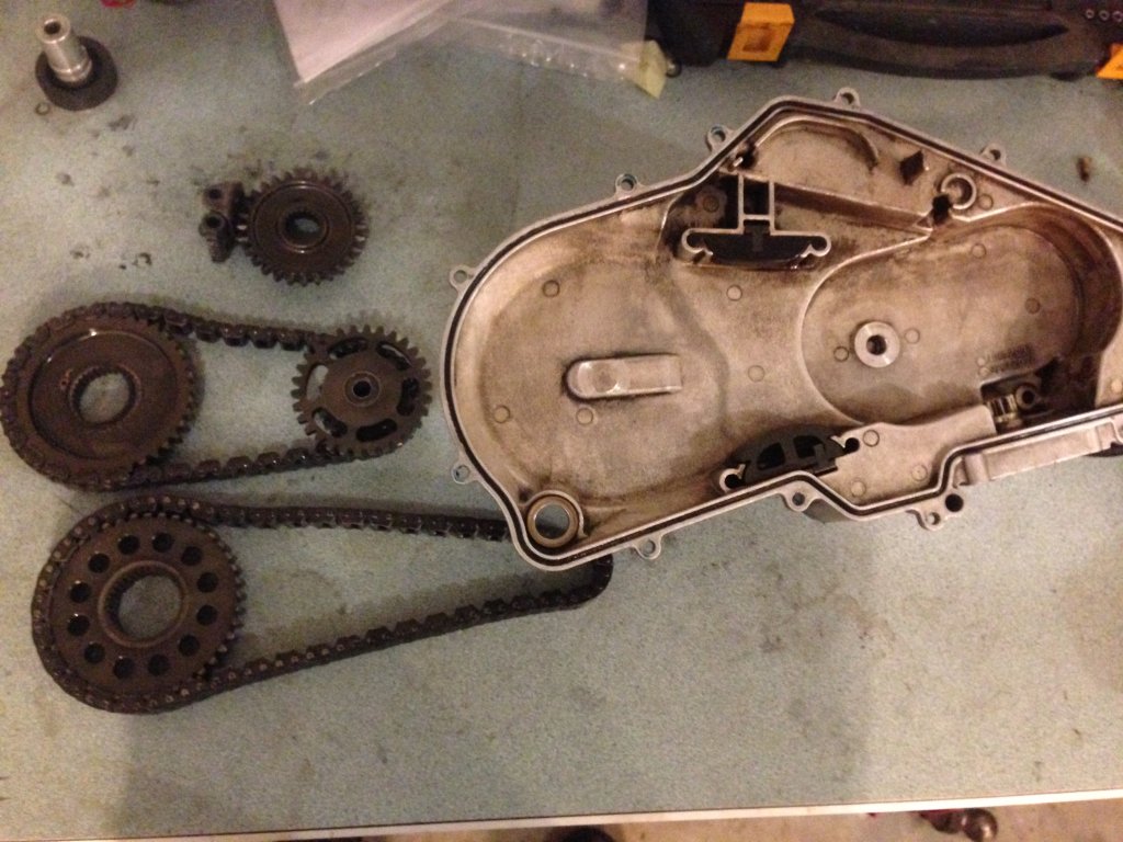

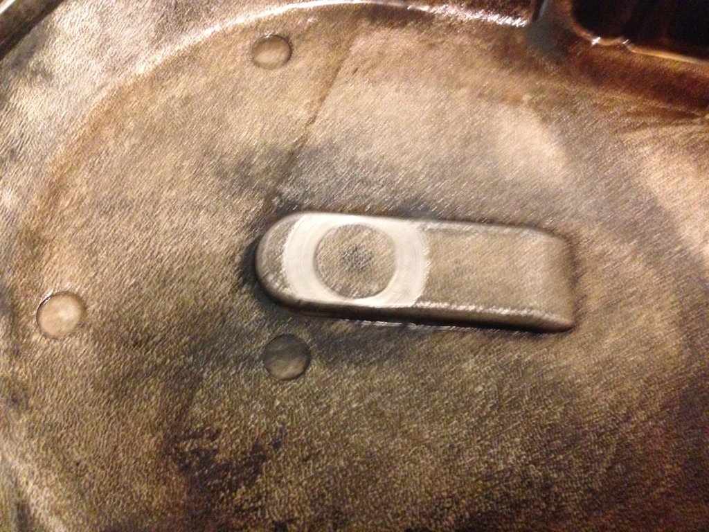

just posting a reminder to everyone with miles on from last year. Take your chain case apart and clean the magnets while changing fluid. The magnets build up with metal filings and chew a round hole in the cover.
I used to just suck the oil out of the chain case to change it. After seeing this I will be pulling the cover every year.
5300 miles.
5300 miles.

seems like there could be a spot to epoxy a rare earth magnet to collect all the metal and keep away

Might be worth a try. The magnets on the axle will still get some though. Keep in mind my chain case had 5300 miles on the same oil.seems like there could be a spot to epoxy a rare earth magnet to collect all the metal and keep away

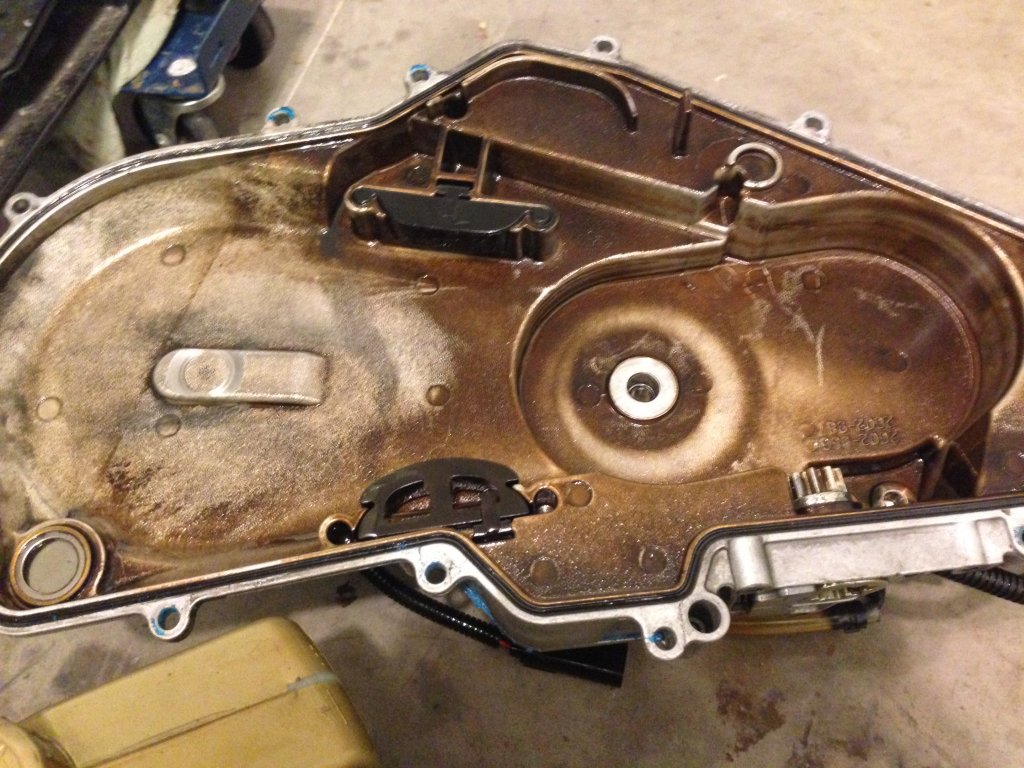

That's the oil that came in it from factory with 5300 miles on it.Joe mine looked a lot cleaner than yours but that's probably because of all the miles you had on yours. What oil did you use? Used oil from a diesel tractor?I think taking the chain case apart every year and checking and cleaning everything is well worth your time. This year I removed the lower panel and used rivet nuts in place of the rivets so I can remove it every year. Man did that make everything easier. I was able to drain the oil tank and chain case with no mess. I even removed the oil tank completely so I could get better access to the case and check and clean everything very easily. I find this Sidewinder is very easy to work on compared to my 1200 Doo.
It was easy to clean up with rag and break clean. Picture below.
