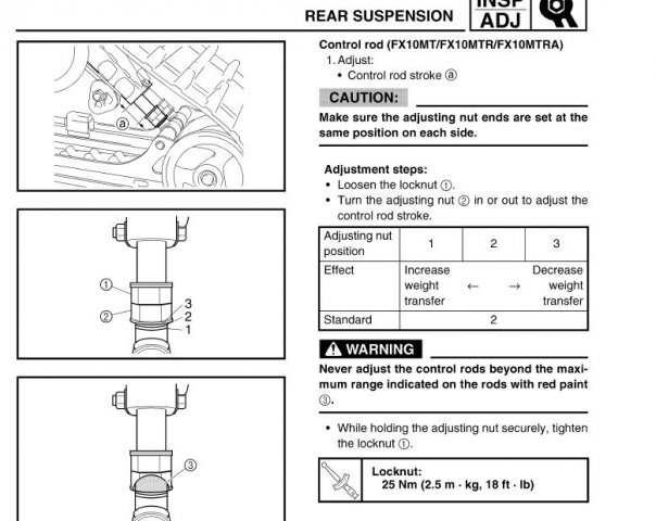

Need to adj your suspension for transfer to get ski lift with or without kit.
Not sure if your looking for more ski lift or trying to reduce it. If your trying to reduce it then decrease weight transfer.

Loosen the front straps for lift or if you just want it some times loosen the transfer blocks so you can flip them out of the way when you want to pull up the skies
