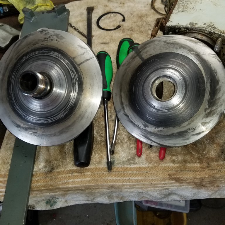

Thunder Products Clutching recommends you inspect your clutches for heat cracks first, then check to see if there are grooves worn in the clutch sheaves. If they are not grooved or worn, they can be saved and re-used. Yamaha has replacements...but are on back-order.
Typical Yamaha primary rebuild is about 8,000 miles, but every sled and rider are different.
If you need help rebuilding your clutch, let us know... We can turn your clutch from dirty and working poorly to like new condition in a couple days (depending on if you need to replace sheaves or not)
- 5,722
- 4,313
Do you offer clutch belt surfaceThunder Products Clutching recommends you inspect your clutches for heat cracks first, then check to see if there are grooves worn in the clutch sheaves. If they are not grooved or worn, they can be saved and re-used. Yamaha has replacements...but are on back-order.
View attachment 155285 View attachment 155286 View attachment 155287
machining?
- Nov 11, 2016
- 548
- 961
- 1,018
- Cedarville, MI
- Cedarville, MI
machining?
Yes
