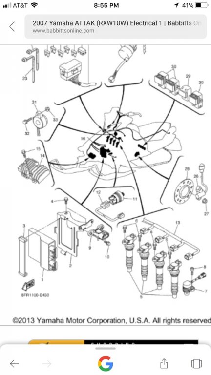

Ringold24
- Feb 13, 2015
- 59
- 258
- Ramsey MN
- 07 Yamaha Attak GT
Part#18 since intake measures at engine and code 23 would be the code for atmospheric. You could swap them I believe as a test. Most are identical.
