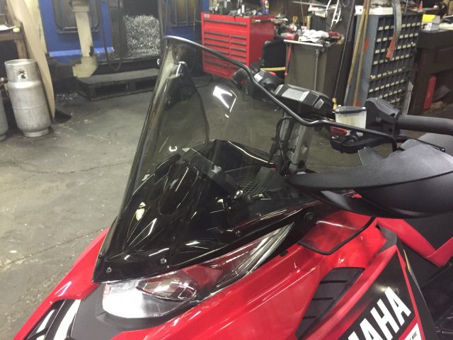

Have the tall wind screen on mine as its only a little more than 1" taller than the mid height wind screen and had the hand guards with the chincy plastic mounts on mine for about 5 minute before i dumped them, as a friend got frost bite on his hands on his 2014 doo and he then put on the skidoo gauntlets with the clear plastic top windows to allow you to see your controls so I put a set on my Viper and they really make a difference, also added a Up north bracket to the rear that allows me to use the skidoo Linq bag so now I have a YAMACATDOO sled...spreading my cash to all manufacturer...LOL

Exactly the same, only different, what I did to my XF7000.We put the Yamaha mid height on. BUT then laid the stock over it on the outside to maintain the look of the stock and it does look a lot better that way IMO...
Mid-height windshield overlay with Cold Guards wind protectors.
http://www.coldguards.com/index.html
Body wind protection is very good. Fingers stay nice and warm.

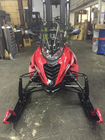

The windscreen is from the arctic cat crosstour 7000. I believe it the mid height one.
Had to mod the lower back portion of screen, but the front mount screws do line up with original holes.
Saw it in a post last year. As for the bag it's just one of the yamaha bags puts out.

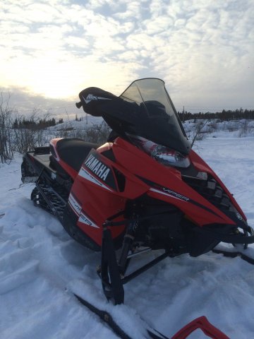

So finally put on the mid-sized LTX (maybe crosstour). Thanks to all for the pictures and part numbers, made finding it easy & makes a difference at -25!!

Now That's one sharp looking ride!
