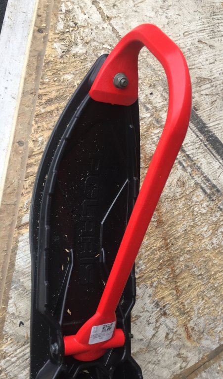

Alright....got a set off current blue loops today. They look and fit up even better than the older black loop I tried last week!
Below are some pics. Front attaches with a pre bent bolt and washer and lock nut on top.
For the rear mount I threaded a coupling nut onto the front skag stud and then attach loop with flanged bolt.
At this point I'm thinking $60 for a set of loops with the hardware needed to fit them on a curve ski. I will work at adding this to my website soon. In mean time you can just PM me on here if you'd like to order a set.

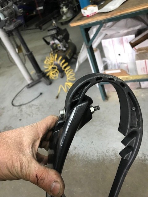

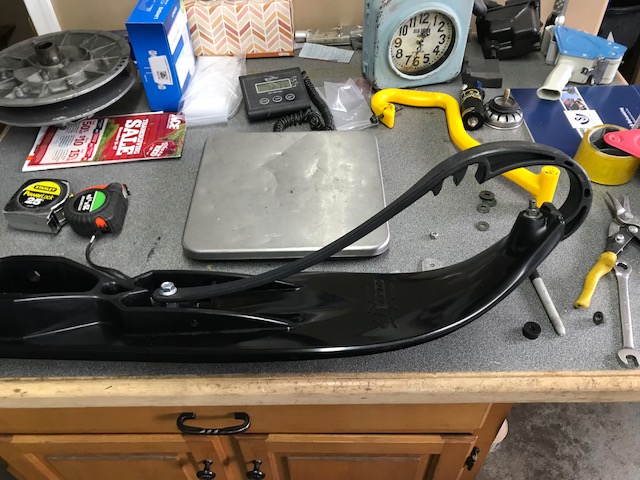

Ok put the finishing touches on this today with the hardware.
Got a nice stainless allen head bolt for the front mounting bolt. Got jig figured out to bend them up in my press.
Beings the front hole in ski is larger than the bolt, I sourced a bushing to address this.
The studs are quite long on the curve skag. Once you bottom the hex coupling nut against front skag stud nut I've found that the rear loop bolt bottoms out on the skag stud before entirely snugging up the loop. Placing a washer or two between the coupling nut and skag nut will address this.
I've added the kits to my online store. Just search for curve and they will come right up.
