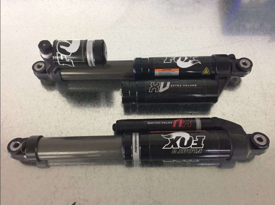

Thanks Rob! I wasn’t sure.Here is a picture of the new shock.

The chart said only good for 2016 up.. so earlier one's are stuck without?

2015 and older Apex sleds have either the Mono rear in a short track, or the 144” tip-up CK skid. The pre ‘16 Vector models all had the Mono. That shock only applies to the ‘16+ Singleshot skid.The chart said only good for 2016 up.. so earlier one's are stuck without?

Thanks.. how obvious is it too see the difference between the two shocks..
Just found this image in the post for 'Yamaha replaces 2017 APEX rear shock' which shows the two shocks side by side. The new shock now has compression and rebound adjustments.
Nice thanks.... so the new one is on top I see.. very obvious.
