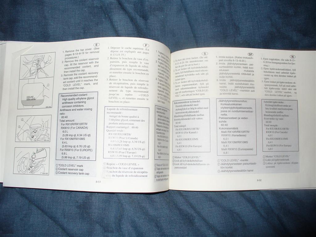

Its funny you mention this as I was thinking the same thing. So thats what I am going to do, just add some more pure antifreeze, most likely 2L or so.
Also, note attached pic with my manual, this is a canadian sled and this is how my manual comes. There is stickers over prior information, meaning that maybe yamaha started updating their coolant levels.
