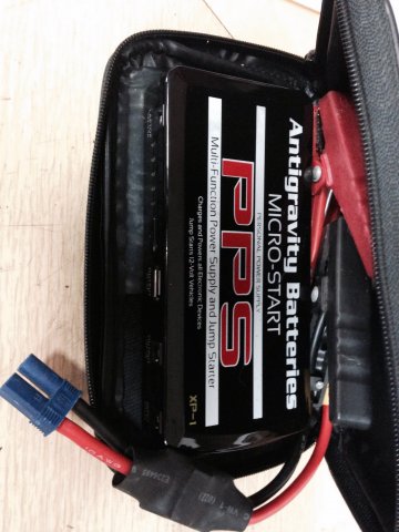

I have this Micro Start boost pack that I have been carrying around for 2 seasons now. Love it. Works great. What do you guys think about running the heated shield for my helmet off it or the new smaller version? I am no electrician is the idea sound? I have a Rollover tether and will not give up heated shield. Too many cords attaching me to sled. Would be nice to have the shield cord going into my pocket hooked to this so I dont have to remove it everytime I get off sled. Maybe even mount it on helmet?

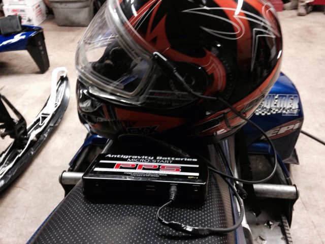

Just cobbled a cord together. Light on shield is lit so assume its working. Will leave it on to see how long it will run...
Was not full charge but close. Let countdown begin.

She is dead. So 4 hrs. Will charge it fully and try again. Not long enough.
I was using the 2a outlet. Maybe a switch or resistor to limit output would help since this shield really puts out. Would like 8 hrs though.

Its 68deg in garage and you could feel the heat coming off shield the whole time. Definitely hotter than room temp. I believe shield would work just fine with less out put. I will get a resistor and wire it in. Put it in positive side?

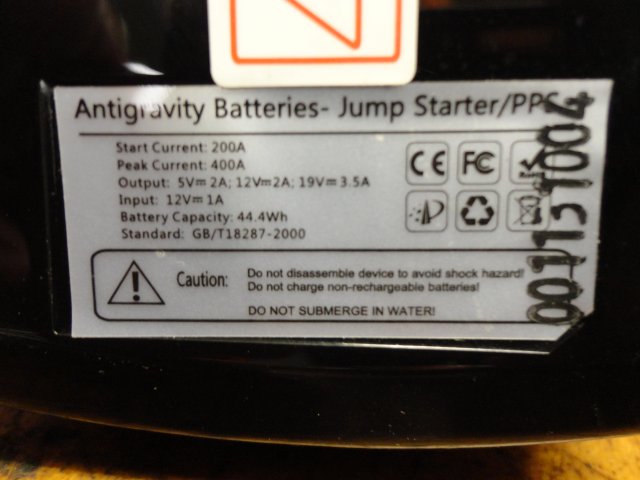

I think this unit must shut off if not at full output since even at 1 bar on indicator it starts a car. It recharges very fast. Already at 2 bars. Here are the specs.

Using a lower amp fuse will not lower power consumption. All it will do is blow if the current is above 1A. I don't think adding a resistor is a solution. It will just lower the heat output and performance.
And converting 44.4Wh to mAh gives only 3700. With a 10 000 mAh unit, that would give 8+ hours, maybe even 12.

So depending on the requirements of the heated shield, when converting the wh to mah, if the 5v = 2a will operate the heated shield, then the mah conversion increases to 8880 mah capacity. Getting closer to 10,000mah specified for 8hrs/12hrs run time. I'm not sure how Polaris Industires does this with their cordless kit but I'm gonna look into it so we can help out more here on this unit.
