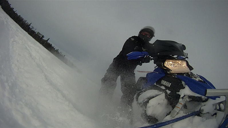

Wow I almost got nauseated on your first set of donuts.. LOL What's sticking out of the tip on the r/h ski? Looks like your loop bolt is backing out?

Mount for the camera.canoehead said:Wow I almost got nauseated on your first set of donuts.. LOL What's sticking out of the tip on the r/h ski? Looks like your loop bolt is backing out?

Yep - mount for the camera. Didn't work out well - it was too shaky or under snow!
That's caused by the top of helmet camera mount. Makes the video look like the rider is 8 feet tall and makes him look like a Teletubby. Contour all the way baby!
