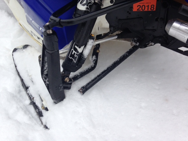

Whatever you do don't use pilots with carbides on the inside and outside with ski savers on both. When I had my Apex I was riding w/that setup and got a branch lodged in the center channel that was a good 3ft long. No big deal to stop and remove, but I also got a rock stuck in there from a section of trail that had a lot of loose railroad sized rocks on it. We tried everything we had to try and pry it out. Ended up riding it a cpl more miles till we got to a lake where an ice fisherman lent us a tire iron to get it out.

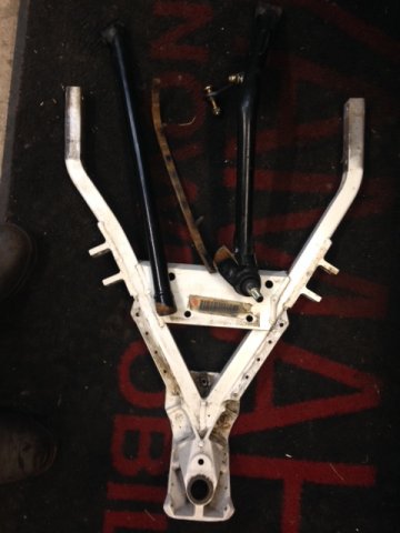

You know if I wouldnt have had that outside carbide my a-arm wouldnt have gotten ripped off. Whatever that carbide hit stopped the sled instantly bending the carbide to almost 90 deg and it left a mark right where carbide starts that looked like a chisel hit. Starting to regret the 6.9 purchase. With one carbide in middle it would have just been plastic scraped off the ski. Good point AXR. I knew I didnt belong on that grade though.
