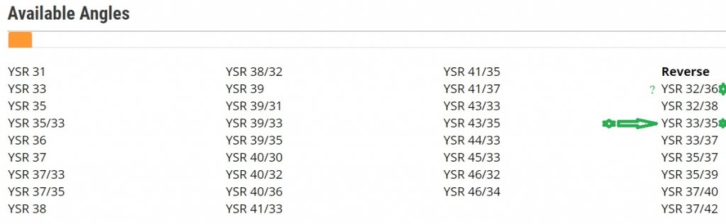

Thinking about getting the Dalton Black orange spring for the secondary. Would it be a smart move to get a Dalton Helix too to avoid the problem of all 3 Rollers not touching the stock Helix?? Or not??
What Dalton Helix is closest to the stock Yamaha Sidewinders secondary Helix? Really didn't want to change too many things right off the bat with the clutching. But also don't want any issues with coil bind and flat spotting rollers either.
And they come with the angle on side, unless you want my brand new one? I can get one from Dale then.
Stock is 35, which Dale Sells...but most are liking the 33/35.

For me that 32/36 keeps grabbing my eye and Id like to test that. But for starters Im sticking with the 33/35 which has had alot of testing this summer on the track. Seems the finish 35 is where we need to be, so id like to stay near that for full shift.32/38 might be a good one

May sound like a dumb question, but why does the stock Helix from Yamaha have one number(35); but the Dalton Helix has two numbers.. 33/35?
What do these numbers mean/their significance?? If I get a Helix from Dale at Dalton, I don't want to lose any top end...so that's why I asked what was closest to stock Helix? Is this 33/35 Helix along with the black orange spring gonna alow full out shift/overdrive?? If these are dumb questions, I apologize...just trying to learn lol.

Sorry, I just assumed you were savvy in clutching Technic.May sound like a dumb question, but why does the stock Helix from Yamaha have one number(35); but the Dalton Helix has two numbers.. 33/35?
The Helix ramp is what the 3 rollers run on, and if you look at where they sit at idle, that is the first part of the ramp and the first angle you see in these choices from Dalton or others. Dalton measures Yam aftermarket helix same as Yam does, that may seem like a given but not all do this.
Now if you look at that helix ramp, you can see that when you go faster the Rollers run down the ramp when the clutch opens(secondary clutch) and where the rollers end up, is the 2nd angle given.
So, As the clutching increase in speed/rpms.....the rollers will go from a FLATTER angle, to a STEEPER angle....(because we are talking about a 33/35 which is what is known as a REVERSE angle helix) Because typically with most all sleds you want a helix that goes from steeper to shallower(a standard helix does this-Not reverse angle)
But for this Turbo, over the first season we feel that this sled needs more rpms down low, and on trail speeds...then more normal rpms up top....so we do this by using a flatter angle(lower) initially in the shift, then it rides down the ramp to a steeper angle which is more stock like(stock is 35). So top speeds rpms are more normal.
Lots more to all this, but that is a short way to understand how the helix angles play a roll in the shift. Sorta like a stick shift car when you want to take off fast, you rev it higher by leaving it in a lower gear longer, same with the bikes, when we hammer down we rev them high before we power shift into next gear....always faster. With a turbo now you have more rpms and higher spool, for more boost.
Secondary spring and its tension setting has a TON to do with the helix angles as well, so they sorta go hand in hand when setting them up....but the spring is where to start for sure, as its the one thing that is needing upgrading.

That is a Dalton reverse angle helix,it is same finish as stock 35 but starts out fast at 33,than translates to stock finish rate,and the stock secondary spring seems to tight,at 5 twists,and close togeather,may coilbind more in stock cast helix.So I don't see how you would lose any top end speed,with same finish rate helix,unless you wrapped it to tight say 80 or 90 degrees of twist. And dales new black orange spring was made because some of us from last year wanted a secondary spring that would give more side force and not coilbind,bingo,this should be it.May sound like a dumb question, but why does the stock Helix from Yamaha have one number(35); but the Dalton Helix has two numbers.. 33/35?
