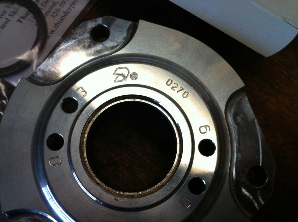

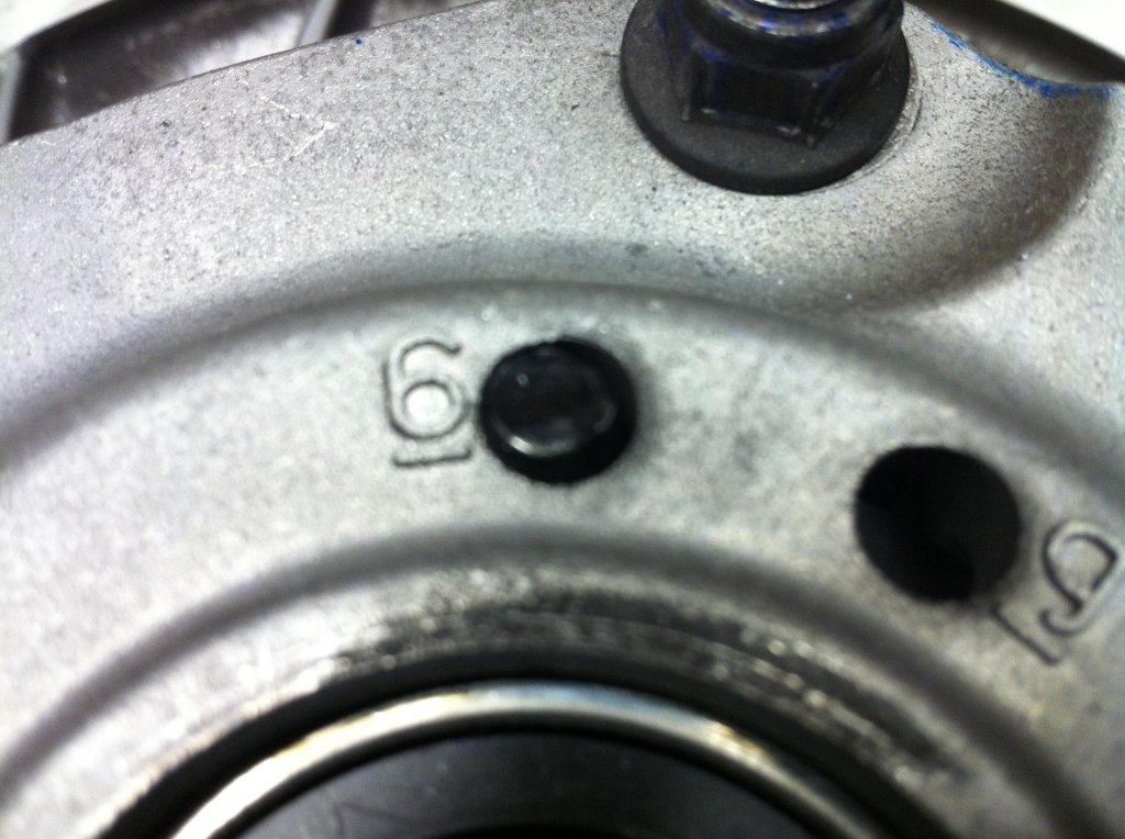

Numbers are on the helix(0,3,6,9) from Dalton too....Add the numbers together x 10%(IE": 3+3=6 X 10%= 60 degrees)
yes 3-3(60 degrees) should be where you want it, especially with the new sec springs we have avail now. Last season we did not have any, so we all tried 70 degrees to try to get more bottom end rpms. New springs will be a world of difference.

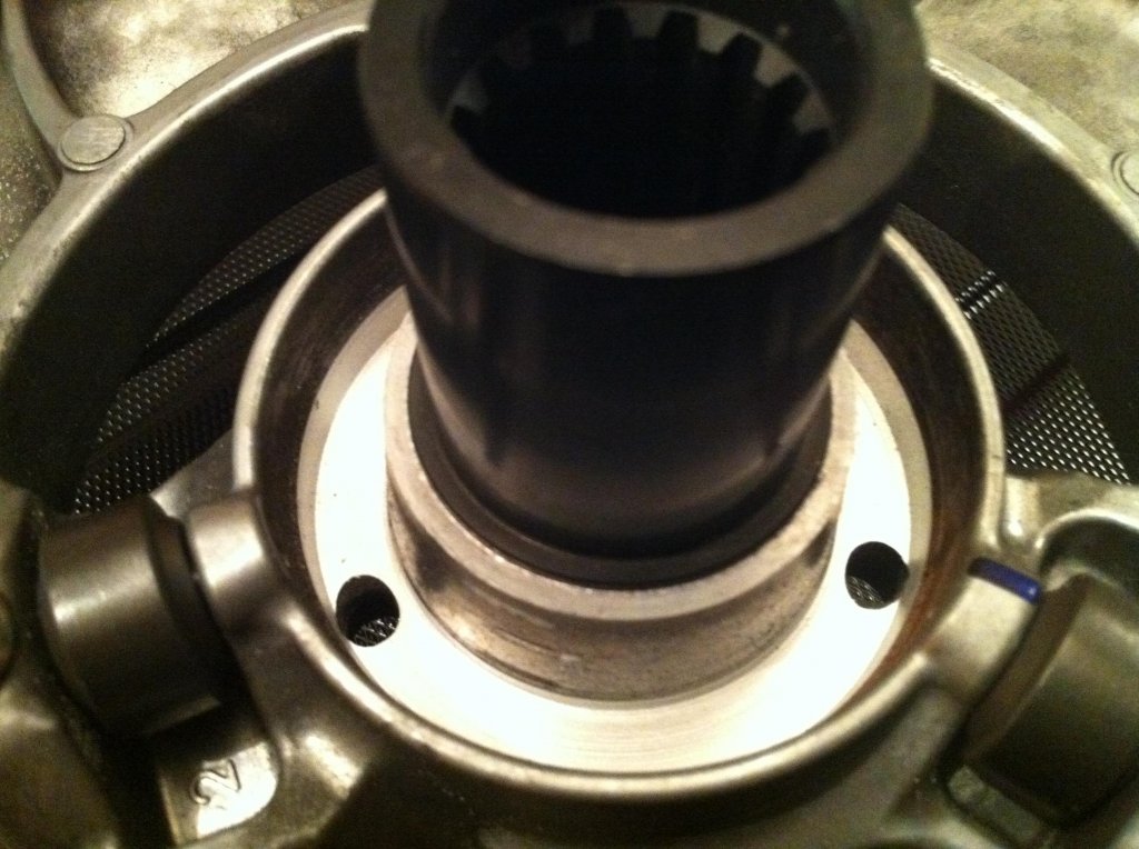

Notice the BLUE markings on stock helix and sheave, these blue marks are the STOCK settings for tangs, 3-3 is shown here.
Here are some pics of tangs and numbers on helix...
Stock helix with 0,3,6,9 numbered holes for tang
3 numbered holes on sheave for tang, notice the number, left side near rollers(2)
Dalton helix with 0,3,6,9 holes for tangs(same as stock)

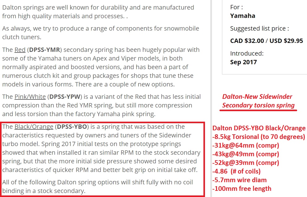

Good spot to post Dales new secondary spring.
Anxious to test this one...
View attachment 130262 View attachment 130263
For comparison does anyone have specs on the purple EPI secondary spring? Alot of high hp turbo yamahas have run this spring to prevent slippage in the secondary.

Wow ordered my black orange secondary spring Friday afternoon and it arrived at my door before 8am this morning. Thanks Dalton.
- 7,503
Agree.....I have always had the best experiences with Dale at Dalton.Wow ordered my black orange secondary spring Friday afternoon and it arrived at my door before 8am this morning. Thanks Dalton.
Things get to me fast here in Ontario too. Always surprises me how fast. Got my B/O and 39/35 helix super fast last week, and the new DTYA1s will be here tomorrow, so my experimenting with other clutch components is over, back to what I like best.
Love how the B/O torsional pressure at 6/1 is right in that zone of 14-16psi.
