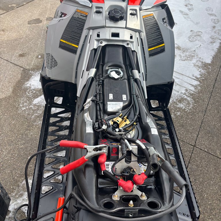

hello fellaz , got a 21 with 885 mi on it , put a new good agm battery in it a week ago, go out today shes dead dead.... shoukd i just order a regulator for it? do a paristatic draw test? just dis connect power wire to batt in mean time so i can use it? whats everyones dash say for charging numbers when its running? .... is their other commmon problems for this? i remember putting the new batt in i git a bit of a small snap hookin up cables to it... key was off kill switch was off... thanks!

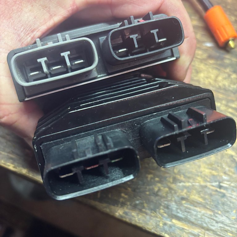

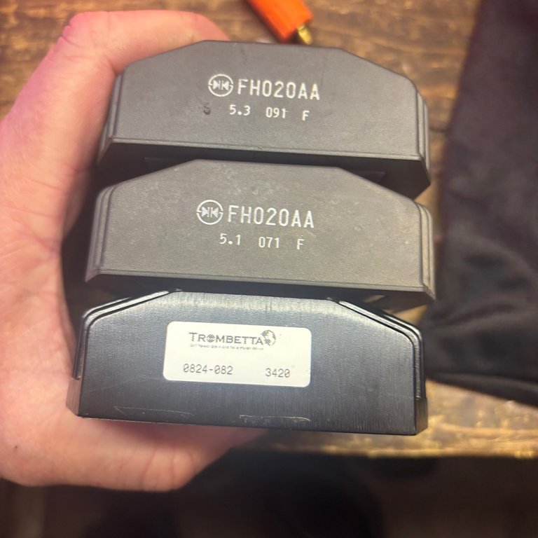

got a regulator locally from a dude parting out vipers, actually i got 2 , i toss 1 in tool box for spare, csme off 2016 vipers, fit the same, sled now charges and im thinkin will cure the dead battery problem whike sitting , time will tell, just the feel of tge viper one felt like quality compared to the original black one felt more like china......one weird thing this fella told me was to use the key to shut it off not the kill switch, told me using kill sw theres a chance of zappin the vr...i cant see it but..??
