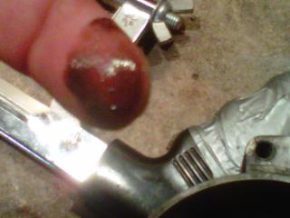

Ok guys maybe its me but today I open the chain case and my oil was a dark grey. I only had 600 miles on this oil it the mobile synthetic.
APEX 06 said:
I'm thinking that after looking at it I seen the top shaft had some rust on it thinking the seal is bad.
If it's grey then definitely water/moisture somehow got in there.
Probably a good thing you were running Mobil synthetic too.
I recently changed mine out to Amsoil Marine gear lube, it states it performs with up to 10% water infiltration?
I had some left over from my last outboard and figured if guy's run ATF or regular engine oil in their chain cases then this has to be at least as good as those?

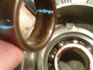

Ya on the top shaft with the small gear the oil on it was a rust color. Thinking that seal is bad. Going to take some pics then post them.
Pis from the top gear and bushing.
I'd definitely change the bearings too while you have it apart. Cheap insurance aginst worn or broken shaft(s).
