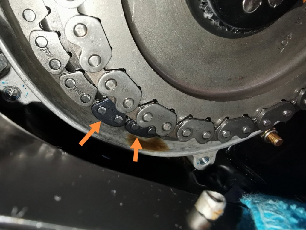

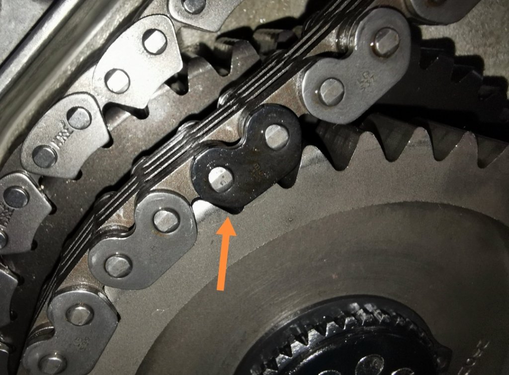

Does not matter if dark plates are in or out.Have I installed the drive chain and reverse gear chain correctly? Should they be directed outward or inward?
View attachment 168134View attachment 168135
