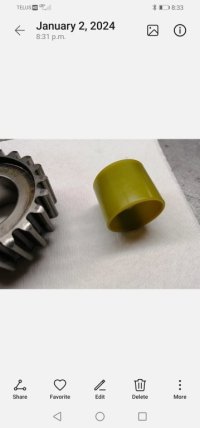

Has anyone ever heard of a plastic bushing being used?
I have a 2017 in here that I'm servicing and there is a plastic/nylon top gear bushing.

PICS ?Has anyone ever heard of a plastic bushing being used?
Yes, my buddy had to have his serviced in Quebec last year on our trip. This dealer installs them all the time they claimed and last over 30k kilometers according to the mechanic. He said that all new winders leave their shop before being ridden with the plastic top gear bushing. My buddy put about 2k miles on his and was perfect when he serviced the chaincase in the fall.

Is it worn/have play ?
- 5,696
- 4,294
No, it seems good. I have no idea how many miles are on it.Is it worn/have play ?

It is crazy how many different “fixes” we have seen for this over the years. Plastic, McMaster Carr, DMC, Prevost, needle bearings, yet Cat refused to update the bushing.
