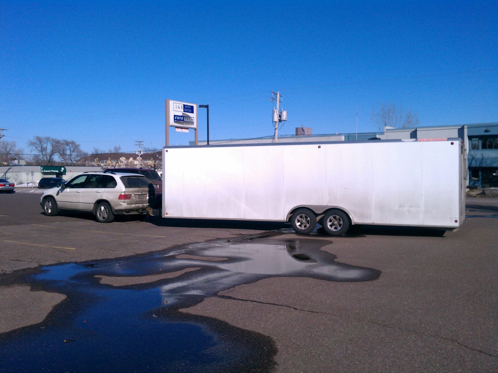

yam177
- Aug 14, 2008
- 1,420
- 923
- Shoreview MN
- www.jbeurotech.com
Dude, that's just sick. LMAO.
yam177
- Aug 14, 2008
- 1,420
- 923
- Shoreview MN
slimjim2525 said:Dude, that's just sick. LMAO.
In my defense it is a 100% aluminum car hauler..... The x5 does have rear air bags
