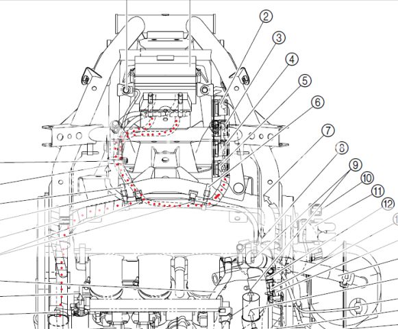

Yeah, I should have taken a picture of the engine compartment before stripping the sled apart. I depended on the parts catalogue, but it doesn't show where the relay bracket, wiring, electrical boxes, coolant bottle goes.
I took the sled apart last spring thinking I would be motivated on getting it back together soon enough and would have everything in my head. Anyway, I got busy. Now I have a mess of nuts, bolts, fasteners, washers, tie wraps etc all over the place. I just installed the subframe, a-arms, steering block, spindles and have no idea what goes on with the electrical stuff and coolant bottle.
So, if anyone has a pic or a link to one in the forum it would be greatly appreciated. I have searched with no luck.

Thanks guys! It all helped!!!
