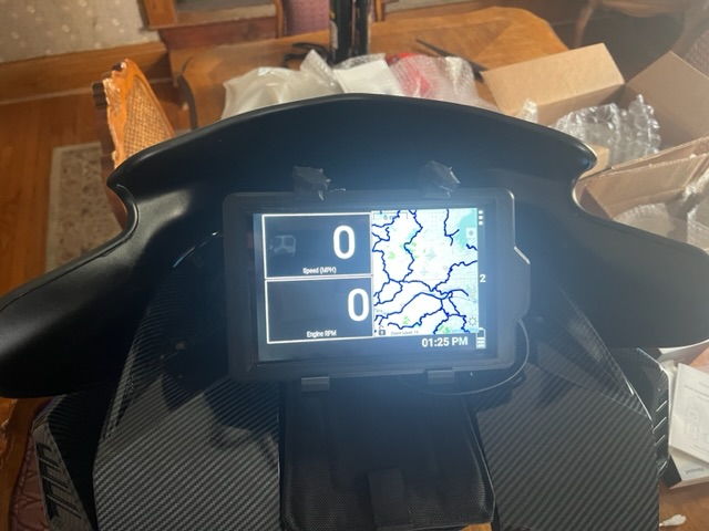

If you zoom in an look to left of gauge you can see the stick on plate. I stick it right on that and go. The accuracy is close. And running a tuned sidewinder it’s much better than a buddy saying. I think you’re 10sled lengths in front vs I think you’re 12 sleds in front now! You can see effects of suspension changes and clutching a aswell as line you pick. Take 3-4 runs for a baseline then change, 3-4 more make a change and so on

Thanks for the pic. Love my NS1 on my 2014 ZR9. Have not put one on my 998. Using the stock gauge with the garmin. I would think between the Draggy and the recording feature on the NS1 you have everything needed to get great data. The combination of the two probably as good as it gets for live data when testing.If you zoom in an look to left of gauge you can see the stick on plate. I stick it right on that and go. The accuracy is close. And running a tuned sidewinder it’s much better than a buddy saying. I think you’re 10sled lengths in front vs I think you’re 12 sleds in front now! You can see effects of suspension changes and clutching a aswell as line you pick. Take 3-4 runs for a baseline then change, 3-4 more make a change and so on
