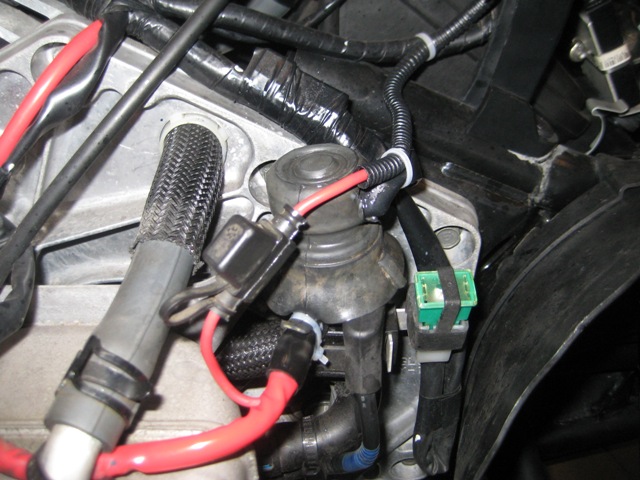

code 12 is displayed because when the key is in the crank position the ECU is expecting to see a signal from the crank sensor but because the engine doesn't roll over there is no signal. Check the key switch and relay connectors for corrosion and/or replace the starter relay. I covered my relay with a rubber boot to keep it dry.
