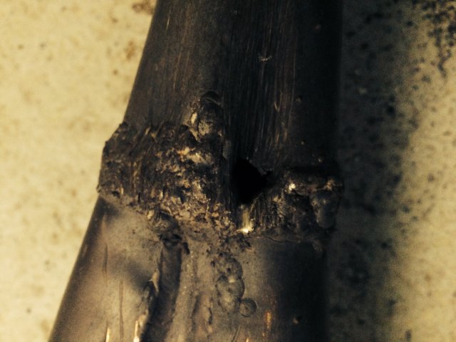

So I heard a little rattle in my exhaust the other day as I was unloading my sled out of the trailer into the garage and started taking it apart to replace the donuts. Once I got it apart I realized the whole top of my header pipe where the 3 pipes go into one is blown out ( I'll try to post a pic later). When I bought it from this guy 3 winters ago it was loud but I thought it was just because he had aftermarket exhaust on it and he just seemed like that was normal when he started it for me but I did get the stock exhuast with it so now my question is, it has the hauck fuel accelerator,clutch kit and I believe it is hauck exhaust too(not positive) but if I put the stock exhuast back on for the time being do you guys think it will screw things up since it has the other stuff done to it. Don't know much about fuel mapping and clutching. Thanks

It does look like somebody made repairs to it. looks terrible.
