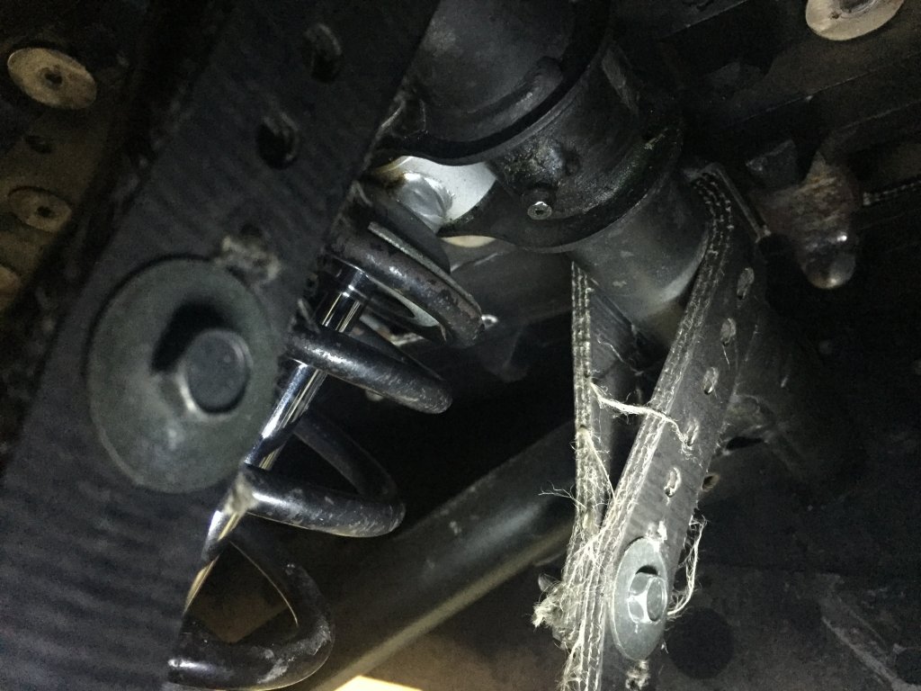

View attachment 135522 went out tonight to move the limiter straps and tighten track and upon further inspection noticed straps appear to be at their tightest point..am I seeing this right? So this would be maximum wrap on the drivers guess only thing to do is keep tightening track until the ratcheting stops? Should I loosen these back to hole 2 what would the effect be of doing this? Thanks
Leave them and tighten the track..
