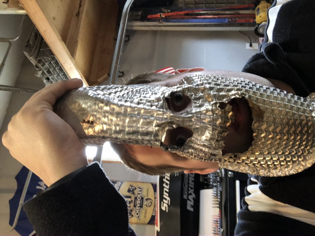

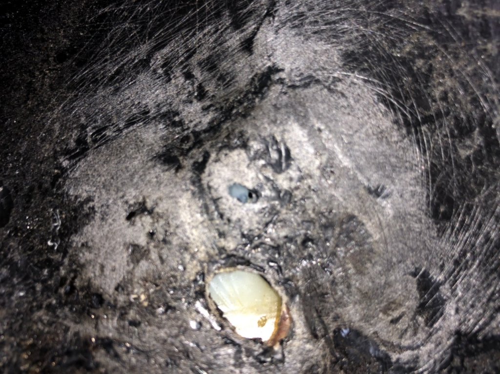

My first call to the dealer was in Quebec and was with regards to the fire and my initial inspection revealing the burnt heat shield and hole in the gas tank. He told me that the heat shield was a wear item and that would not be covered under warranty. I did not realize the flex pipe was broken at that time. Now that I have it apart, I’m hoping they will re consider knowing that it was the failed flex pipe that was the root cause.
Heat shield is not a wear item. Brake pads are. That’s the most ridiculous thing I have ever heard. Maybe if it was on bottom of a car or light truck and rusted out.

Not only 998's. I have a 2018 Vector with the 1049 & 4,800 miles on it & the flex pipe is already broken. On the last 3 Vectors that I have owned I have never had to replace the flex pipe & these machines had over 10,000 miles on them. I think that they are using a cheaper material on the newer sleds.
Probably true about the material. Inconel is triple the price of 316 stainless steel. If there’s one thing China knows how 2 do it’s using cheap metals in their products.
I worked for Flexonics years ago, this stuff was so expensive that if a material handler damaged a coil of Inconel they pretty much $hit canned them on the spot.
