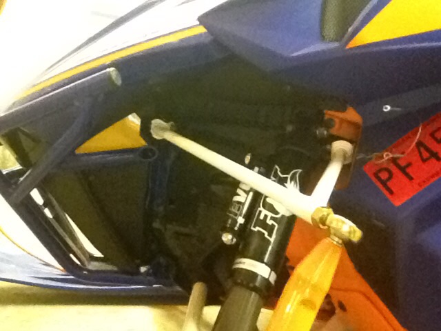

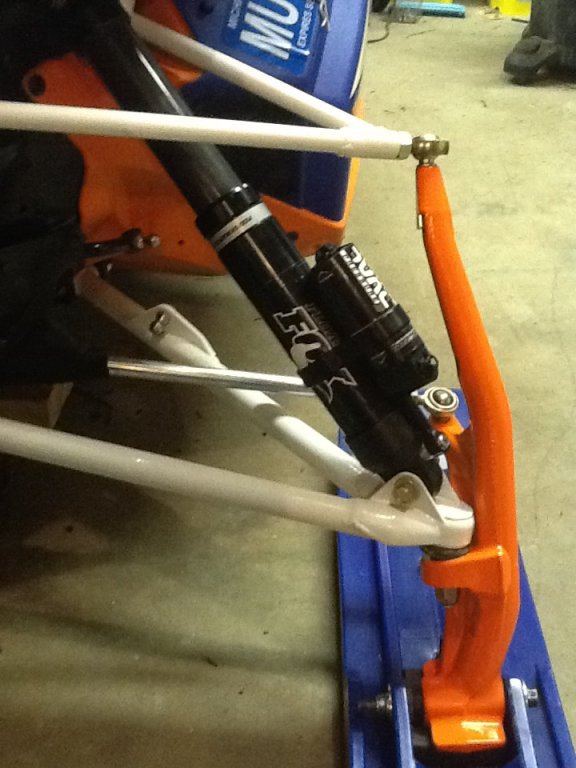

Just so everyone is clear, Hygear will fit up to '15 front ends with the old style upper arms. If you have upgraded to the 16 mountain upper arms and spindles in with the 38" or 40", or if you have a 16 or up with the new style swept back spindles the Hygear kit will not clear the upper arms. You can run the shocks upside down, but that puts the Hygear in harms way low and ahead of the spindle. I have run the Hygear on my 42" front end and liked it, and the new 16 40" front end with the Hygear Kit on the shocks upside down with no ill affects. I now have gone to the 16 38" front end and am running the fox EVOL upgrade with 90 degree caps, and there is little difference between them other than a bit more sir volume in the Hygear kit. If you go with EVOL on 16 and up new style mountain front end, you need to get the 90 degree caps so that the EVOL canisters clear the arm.

I Put those on for SnoNinja. Talked Carver into swapping out the regular caps to the 90deg so yes they can be ordered seperate.I'm not sure if a 90 degree EVOL kit is available. The newer spindle sleds that come with fox floats already have the EVOL canisters installed from the factory.

Item No. is 206-61-204-2 Body Cap, EVOL 3, 90 degree, non rebound adj., no heim grooves. Note that I don't believe that this will work with spherical bearings. It does work with straight bushings, and with the spherical bushings that came on the 15 XTX LE models.I accidently sent the slip with the shocks. SnoNinja will post it I would think.
