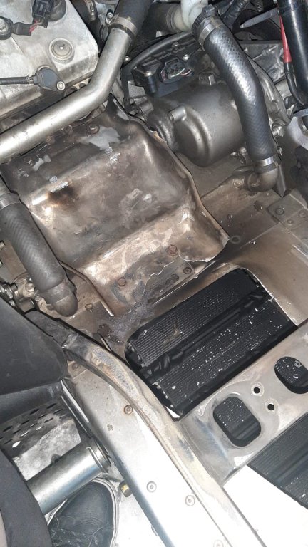

Had to change new sparkplugs yesterday. Sled did not want to start and when it did, it only ran on 1 cylinder.
And we had to weld the exhaust from the start to end. So now we have one full section with the flexjoints. We also made new connection point to hold the exhaust in place under the seat.
My son rides that thing quite hard on our non groomed trails, so if there is weak points on the sled, they will break.

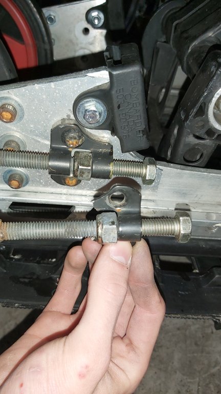

@Ike Tell me more about this skidoo skid you have installed in your phazer please. What model is it and what mods were done to make it fit. Thanks GregView attachment 160303View attachment 160304View attachment 160305
I did order FX Carage works flex pipes. Home made ones lasted 1400 km.
And we have to get a new adjuster to the Ski-Doo skid. Hard landing broke it. Just might be that rear axle was loose.
