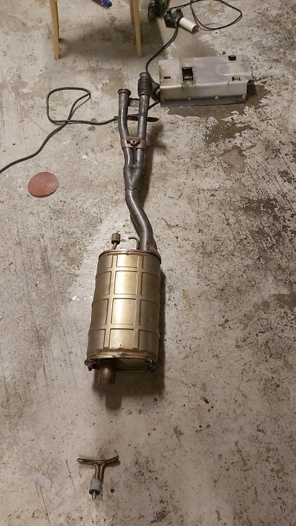

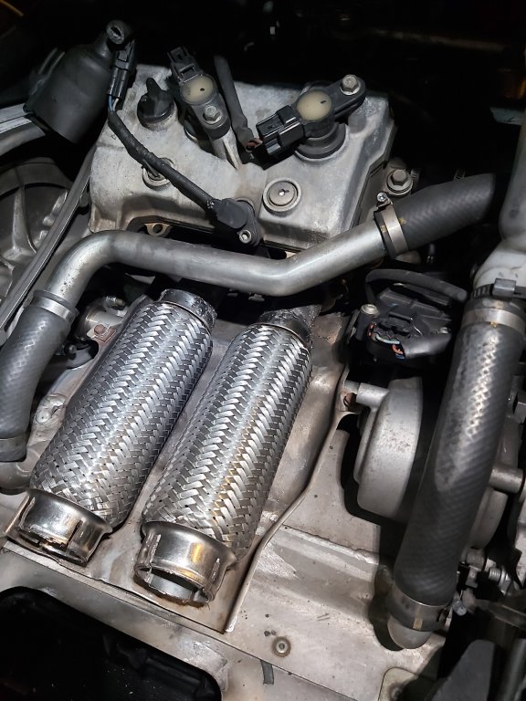

For that, I'd recommend going to these replacement flex pipes. Also eliminates the donuts entirely. They're in Canada so shipping and transit time will be a factor.
https://www.fxgarageworks.com/

Where did you find those? I had looked at something like that but they were too long like these or the wrong size. They're much longer than those from FX Garage and would need to cut more of the pipes. I guess it doesn't matter since the original flex were broken anyway.
