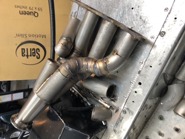

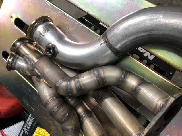

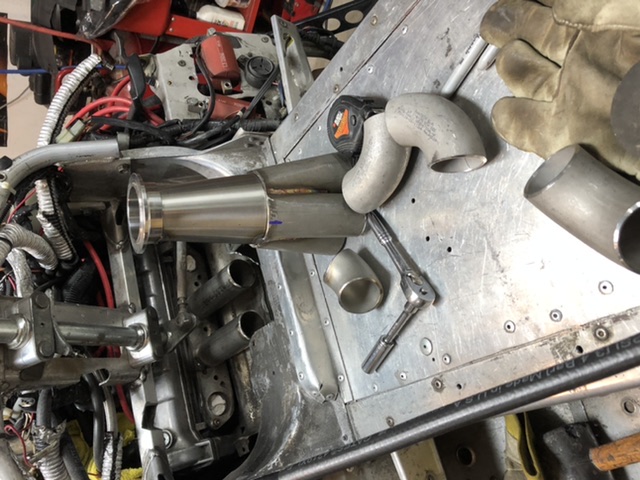

Some of the progress so far . Lots of work fabricating new header . Now I know why headers aren’t cheap to buy lol . Should flow nice this setup .

That’s not gonna restrict anything. Nice work!
What kinda HP are you shooting for?

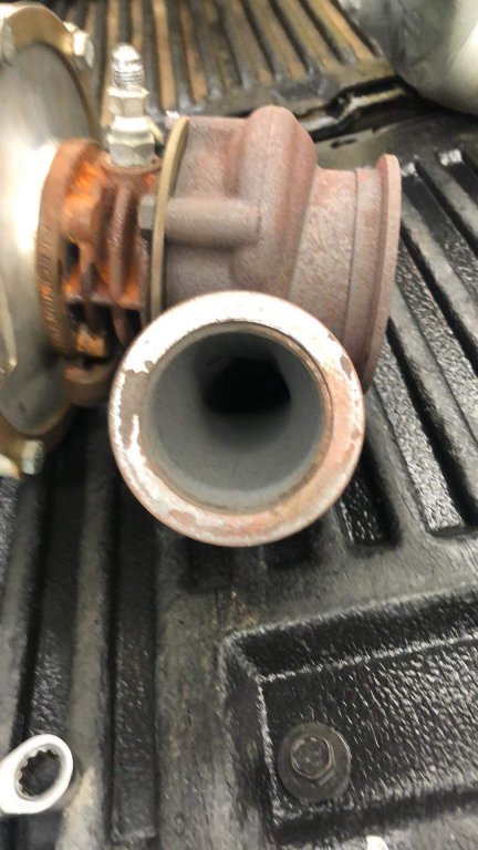

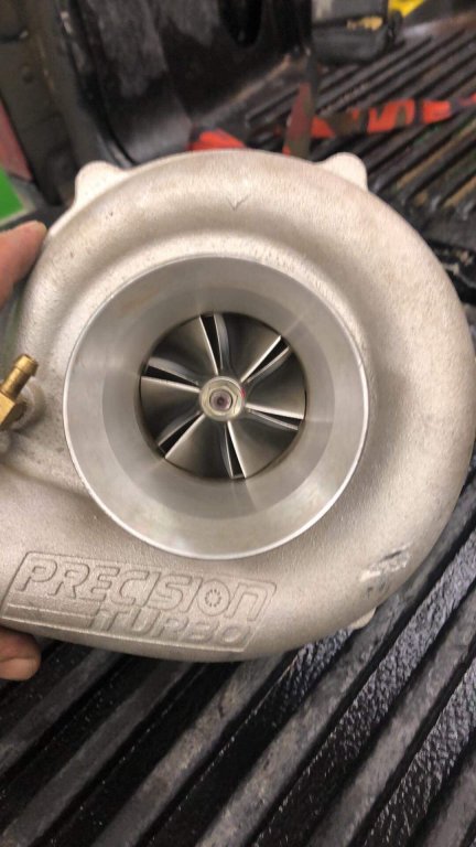

That’s a precision Hair dryer, what are the numbers on it?
rx1 fern
It’s the 5558 turbo . I’m shootings for 500 plus hp .That’s a precision Hair dryer, what are the numbers on it?

What a/r hotside?

It’s the .64 a/r . Thanks alsoThat outta get-er-done!
