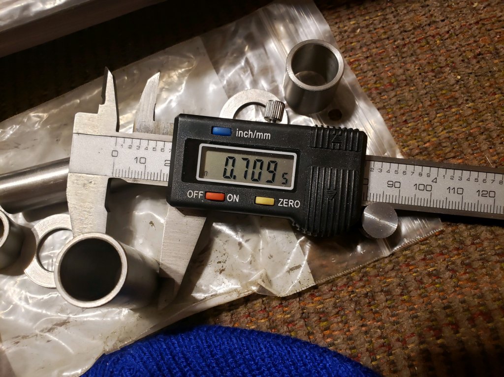

This is the UP Bushman nytro ski bushing.
I dont have measurements for the spindle but this might help. Measured in inches.

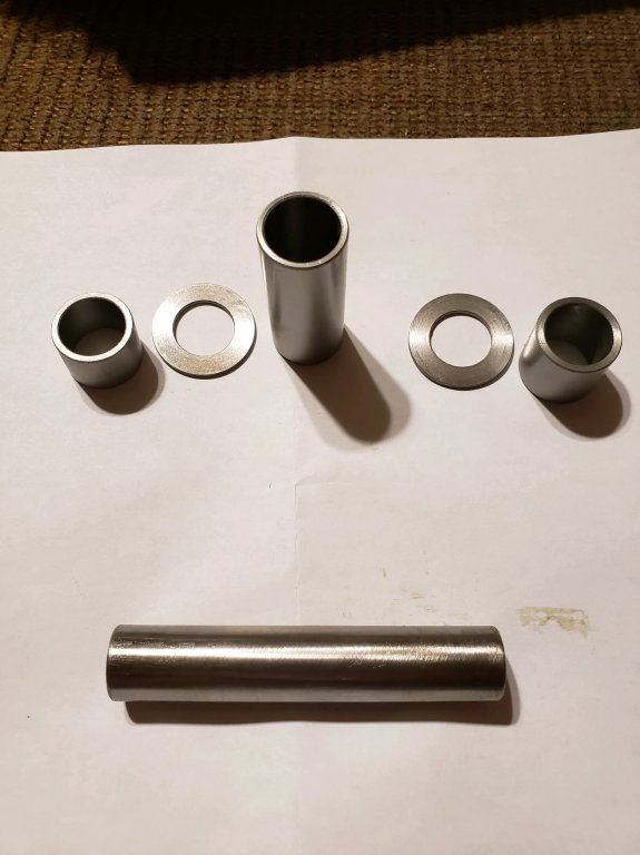

This set up works great for worn spindle holes.
He says to loctite the bushing in when spindles are worn.

Thank you, this will help. Im guessing that my wear is not all from the bushing.. so Ill have to see how bad it is.This set up works great for worn spindle holes.
Dr. FeeLGooD
UP Bushman nytro ski bushing set is the only real fix worth doing that I am aware of. Stock bushings are an embarrassment.
