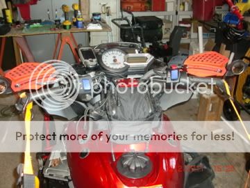

Correct I use the CR racing under bar mount which just means it mounts on the back side of the risor. Then I made a custom one for my SC gauges mouted on the front side of the risor and matched the angles so they match.
Here are some picts:

I didn't think I would like the gauge where it is but its perfect, even when standing. I find it much ore visable and easy to reset the trip meter, etc when its in that position. When I started I wanted to see it while standing, but who wants to look at a gauge while standing so I did this which is better viewed while sitting and cruising on a nice straight trail, then I peek down and check out the gauges make sure everything is ok.
Either way it works well. You will have to extend your wires to the gauge pod, at least I had to.
