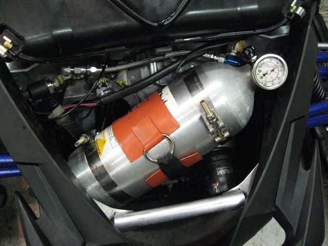

- '18 RTX 50th "Winder"
Beerman said:You can't see it all that well in the pic, but there is in fact Ulmer's relo kit under the N2O bottle. It fit with no problem.
wow so it does fit!!!....i had that same NOS kit!
that looks great!
Dan
Super Sled
- Feb 25, 2009
- 3,631
- 1,218
- Summit X
Nice pic Beerman!!!!!!!
