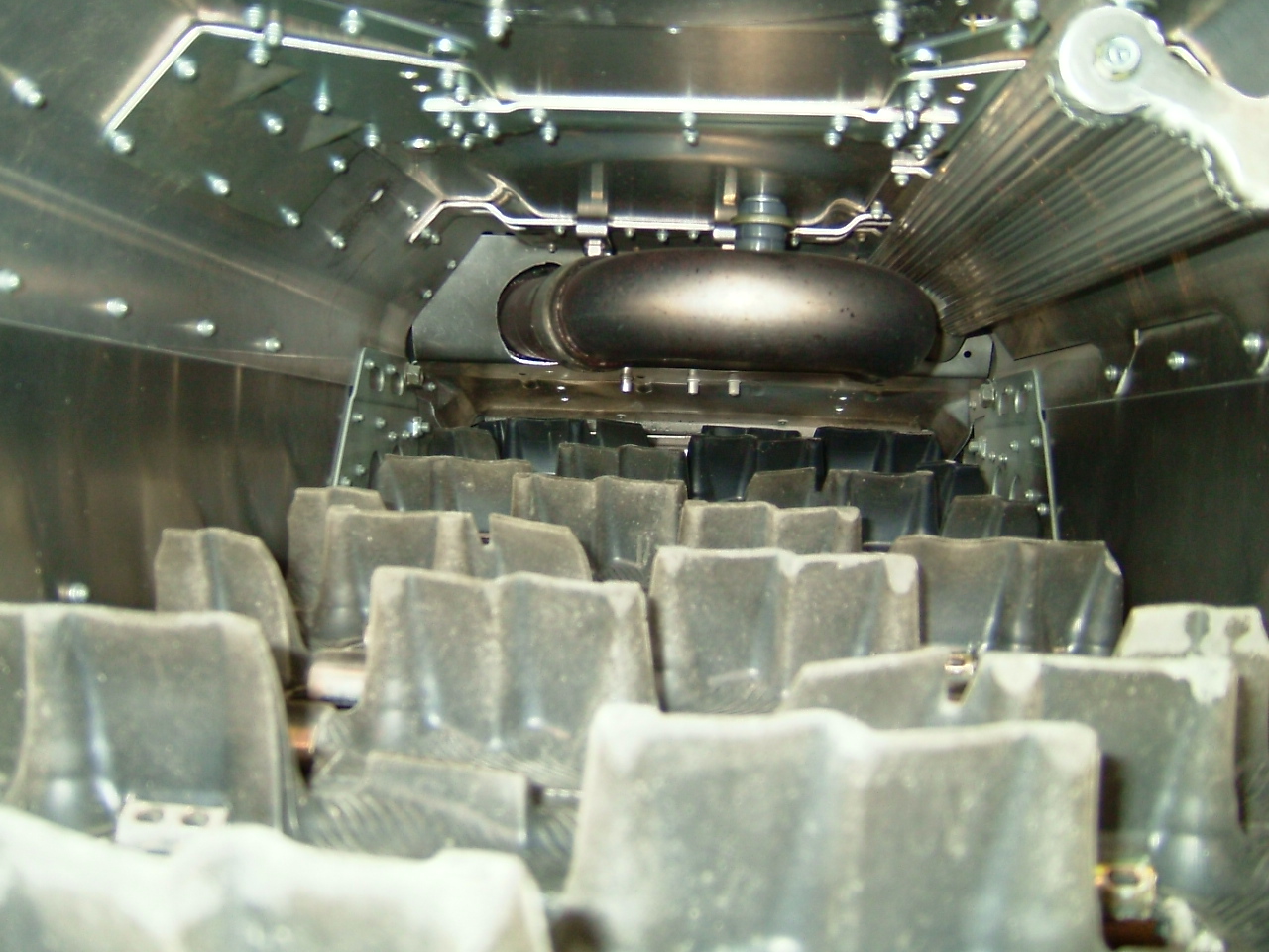

Yamaha has tried the tunnel dump. The reason they do not useit is they were afraid someone would let their sled idle for a long time and they might damagethe track. I've ran a tunnel dump on my turbo vector for 2-yrs and had zero problems the majority (90%) of my riding is boondocking in the mountains. I currently have a tunnel dump on my T-Nytro and I have not had any ill effects in performance.

Here are some quick pic's. I would probably had routed it a little differently had I designed it , but I haven't had any negative issues with it yet. I just put a sheet of aluminum to cover the hole where the stock exhaust went through the tunnel. Before you put a heavy apex seat on I would enclose the space that is under the existing seat. It will give you more storage and a better seat. ( I used to have an Apex seat on my Vector)

thsi looks really interesting...can you either show a drawing from the top down, or more detail on what we are seeing ont eh left side there?
it appears you have a shroud of some sort over the 180 degree turn back...not quite sure, but this looks really good...
so you are going mufflerless right? How is noise ? idle? WOT?
