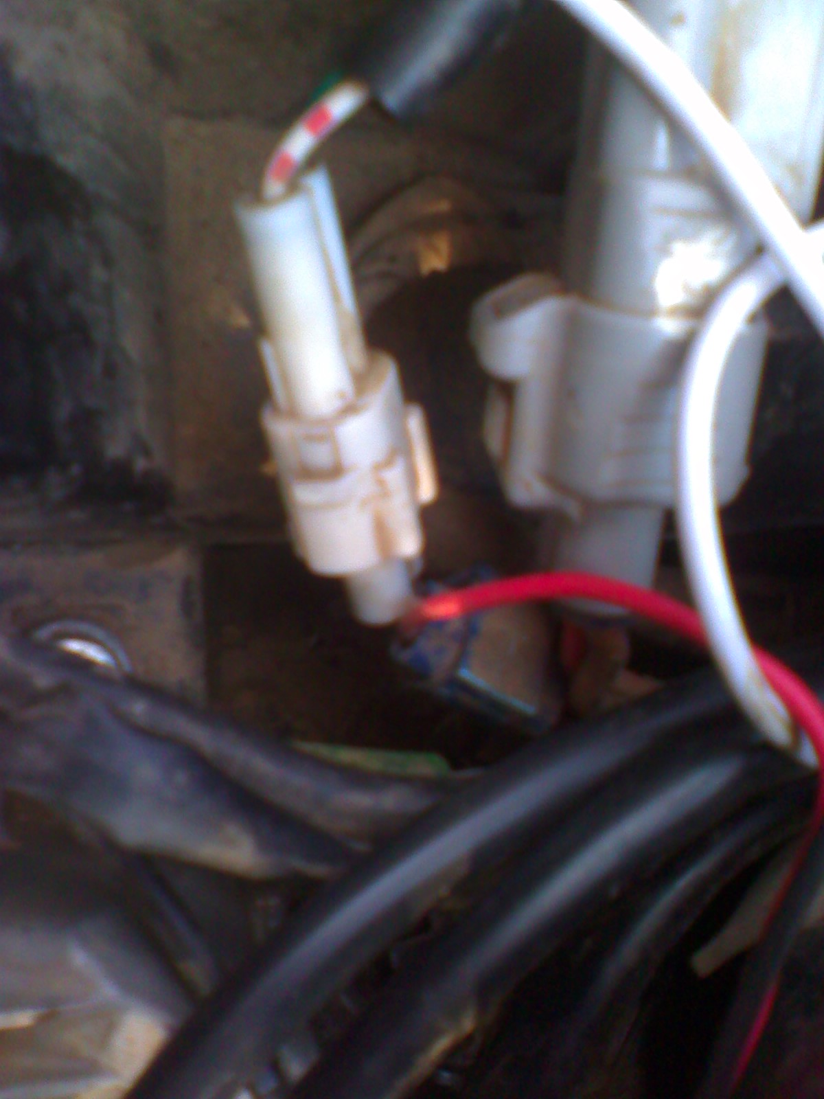

Pics would be great if you have some. Electrical work isn't my thing, but I learn well with pics.
I'll see what I can do, just in the middle of 3 truck builds, and work. But i'll try to get out and take some pics.
Well here is some pics, don't think they will help any, but I could do a wire diagram if needed. I didn't get to take the side panel off to get a pic of the reverse wire, too much other junk to work on.
