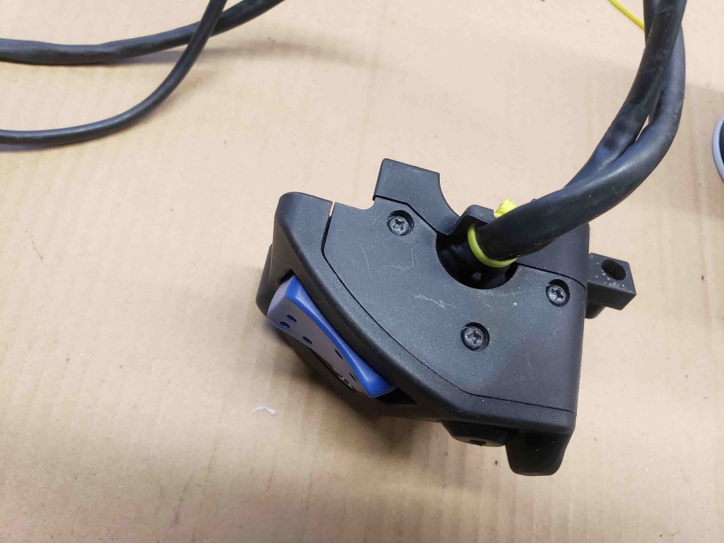

I recently had my heater switch start acting up. The up position didn't want to respond well so I took it all apart. I was wrong in my previous post, these actually have three wires going to them. One common wire and two switch contact wires. There's a few screws to remove and then I had to pry out the switch through the top. Then I pulled back the rubber seal and pushed out the brass pin. Some 600 grit sandpaper polished all the contacts nicely. All back together and it works perfect again.

You have to remove the entire assembly from the handlebars first. Then there's a few screws on the side that have to come out to remove a black cover. Then snip a zip tie and remove one more screw. There's a small steel plate that'll come loose after that last screw is removed. I used a pair of flat screwdrivers under the blue rocker switch to pop it up and out. It doesn't look like it'll come out that way but it does. It's a little finicky shoving it back in but not too bad. Make sure you also polish the three contact pads inside the switch too. I wrapped a little 600 paper around a tiny flat screwdriver to reach in there.

After looking at the assembly again I noticed that you wouldn't have to remove it from the bars to get the switch out. I removed mine thinking the switch came out the back side (it doesn't) and also to bring it in where it was warm. It's basically a zip tie and four screws that come off the right side, then pop out the switch.
