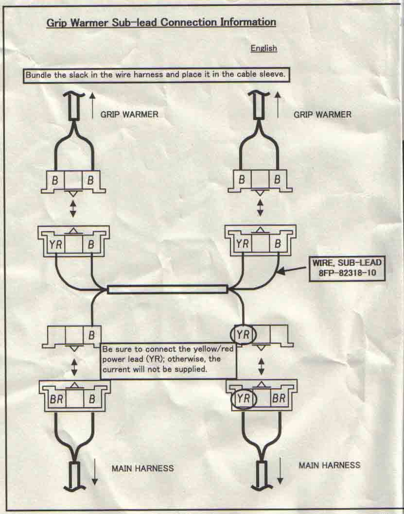

06 RTX, Did the update based on directions in box. threw code 81(problem in hand warmer circut) removed pigtail and code went away, grips heat up just fine.
What the pigtail does is change the warmers from a 2 wire system to a 1 wire system..Installed mine today abd they work fine..Even read the instructions..LOL

OK, I did not see a copyright on them, so here are the instructions for the APEX bars, in case anyone neds them.

Ok so what happens if I wire the 06 bars I have the same way my 03 bars were?
The 06 bars don't put out enough heat..I think because of the aluminum end hook..If there was an easy cheap fix for this I don't think Yamaha would be doing the deal on the bars..Good Luck making them work..
