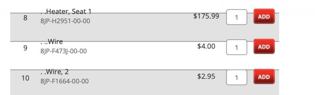

For my '17 seat the heating element is $176!Has anyone added a heated seat to a sidewinder that did not originally have one
if you did can you let me know what you orderd and what you had to do.
Thank you guys and girls
Think I am going to try the heat demon.
