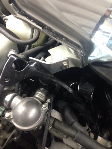

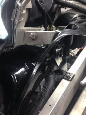

Few pictures of the ones i made.

Thanks for the advice guys ended up taking everyones advice and made this little sheet metal bracket. Ended up costing about 3.50 for a steel hardware!
Bingo. I couldn't find any photos I had, but I made something very similar years back for my 06 GT from a framing hanger I had laying around in the garage.
