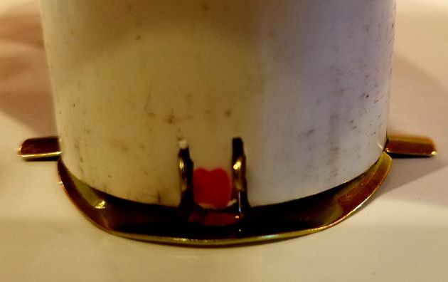

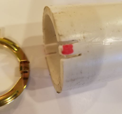

I just installed my headlight adjuster and it works great! I chose to install the knob on the left side of the shroud (ala MrSled). Clean install and the adjuster stays with the hood instead of being tied to the frame of the sled.
While in there, I also installed some cheap LED bulbs. I had a heck of a Time removing and reinstalling the retaining clips.
I searched to see if I could find some kind of tool that would help but I couldn't find anything. So I came up with a super cheap and easy tool that really helps the process and may help someone else.
The problem with the retaining Clips is that they're bowed (springy) so that they put some pressure to keep the bulb in place. This means you need to apply pressure while turning the clip to install it.
I took a chunk of inch and a quarter PVC pipe cut two slots on each side to fit into the retainer clips.
It worked pretty darn good! I was able to push in and turn at the same time allowing me to get the clip back in place.

That took you just made is identical to the tool that comes with the Roctoyz HID kits. It works slick.
GR8BBQ
- Mar 23, 2018
- 728
- 875
- 1,138
- Hamlin, NY
- 2017 Yamaha SRViper X-TX SE
2017 Ski-Doo Blizzard 900 ACE
2001 Yamaha SXR 700 Triple
1995 Polaris Indy Lite
LOL, great minds think alike I guess!
