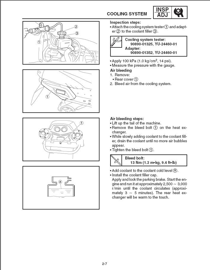

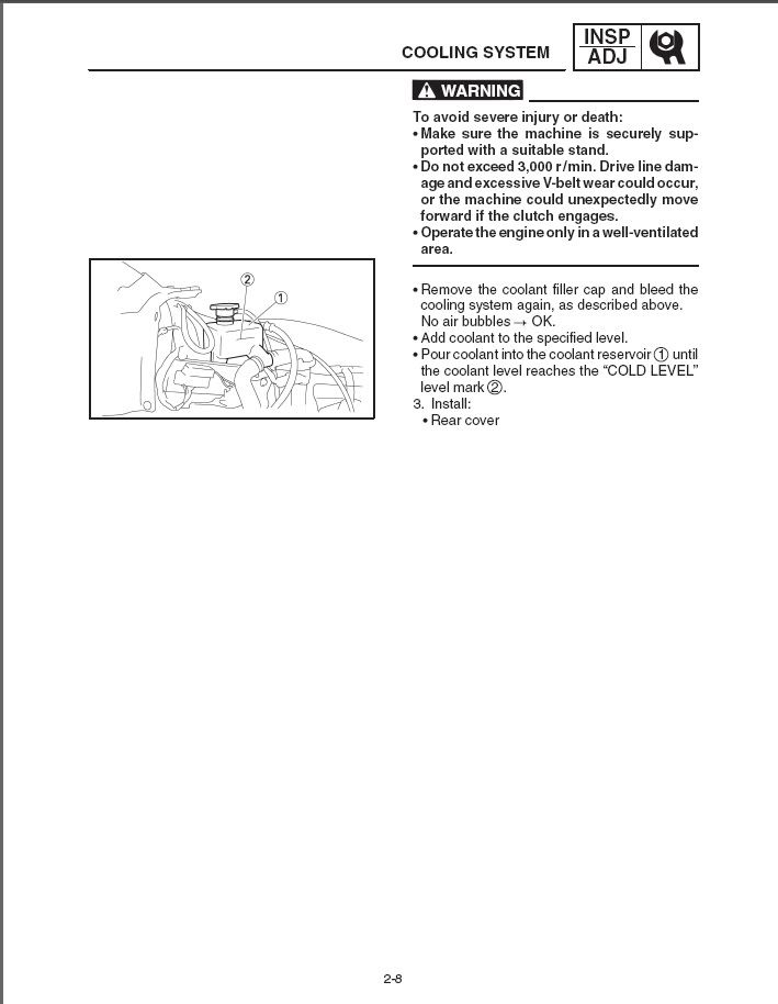

Provided you filled with not too strong pre-mixed, i say you have an air pocket. You can try to bleed again from rear bypass tube.

I agree with the above, too strong coolant and/or air lock in the cooling system. The easiest way I found to burp the air out is to run the sled up a steep snowbank and lock the parking brake. Keep the front elevated for a while and rock the sled side to side. Any air in the system should make it's way up and to the front where it will burp out the coolant overflow tank.

Thanks guys!!! I also read something on here once about someone getting a big chunk of ice in front of the front exchanger and not letting any new snow on it. My mixture should be pretty close to 60/40 and I also put some Water Wetter in it. When I refilled the system, I pulled the screw out of the rear tube and filled until coolant came out the hole. I then put the screw in and finished filling the system. When I go out in the morning, I will check for ice. If there's no ice, I will run it up on a snowbank and rock it as per Grimm to try to "burp" it.

You can also bleed the system by driving up a very steep snow bank and "slowly" open the cap while the machine is running. This releases the bubble from the filler bottle. Blurp the throttle a bit and you'll see the air come up.
I had the same issues and did that on my RX1 and it worked great. Best of all you can do it anywhere on the trail.

So, here's the scoop....I ran my sled up a steep bank, pulled the filler cap, watched my temp rise over 200, backed it down, shut it off, pulled the cap again, and it bubbled quite a bit. The first two times I did this, I got alot of bubbles. The third time, only a few bubbles, and the forth time, no bubbles at all, so I called it good. This did improve the overheating quite a bit. Riding trails with some loose snow, I ran an average of 190-200 degrees. When we hit a road, it would run about 205 or so. When we stopped at a 'T' or something, it just gets hotter and hotter, I saw it get as high as 215 just idling. I tried to keep snow on the running boards and keep moving, but man it's a pain. Does this sound normal for the Warrior or do I have something else going on??? I had my '03 RX-1 for two years and saw the temp light one time!!! If this is what I can always expect from my Warrior, I will definetly be adding a rear cooler when I get home!!! I've got some Water Wetter with me, and I thought about adding some in the morning before we head out. How much, if any, should I add????

Keep riding and do it again. Sometimes the air bubble gets locked in a spot and take a while to come around again. Also, feel you running boards. Both should be equally hot.
I did mine about 3 times in 3 days before it was all cleared up.

Getting any more air out of the cooling system? May want to consider lifting the rear-end again and bleed the air again.
Once you get all the air out, typically these sleds do not experience what you are describing. But the rear cooler does help. Only thing is, with the rear cooler, you have no temp light coming on when your frying your hyfax. Point being, ... even with the added cooler, you are still forced to find the loose snow.
