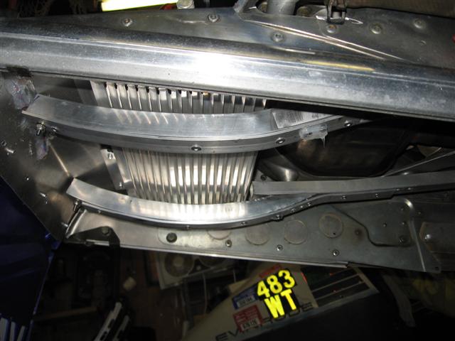

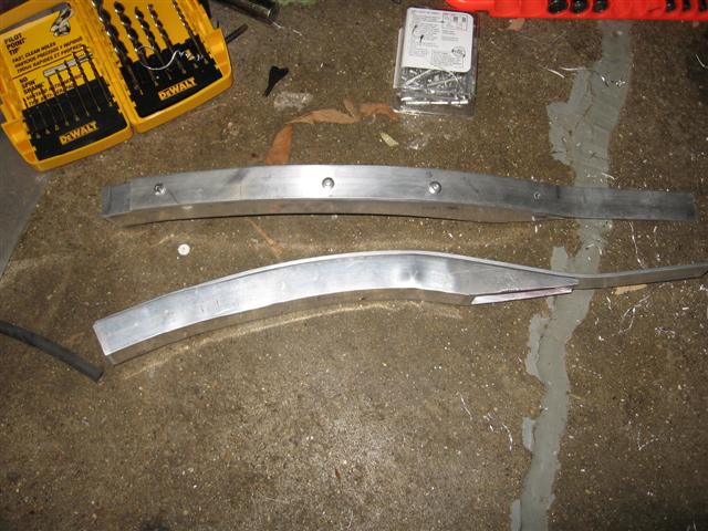

sleddheadd
I made my own protectors out of square stock from Lowes and I used aninch and a quarter conduit bender to bend it up. To get the shape I took a piece of cardboard and traced the rough outline of the cooler. It was really pretty easy. Good luck!

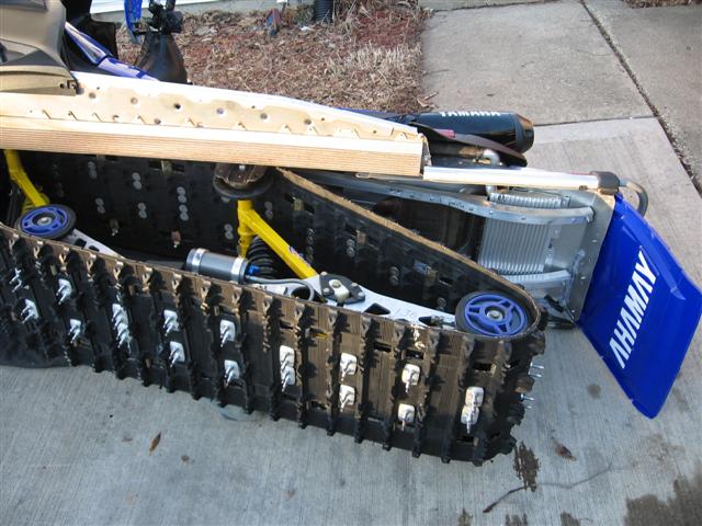

4strokelover87
I am doing something similar but without having to bend anything....I will post pics of it when I get it done, hopefully this weekend!!!
4strokelover87
Got it done this afternoon!!! Here are a few pics, along with a pic of the new snow flap I also installed!!!

You might have a problem with the sharp edges cutting your lugs. I had a similar arrangement and noticed the problem when backing

4strokelover87
I had thought about that....I think I may bend up a couple pieces of aluminum sheet and rivet over the opening in the front to cover the sharp edges....thanks for the heads-up!!!!

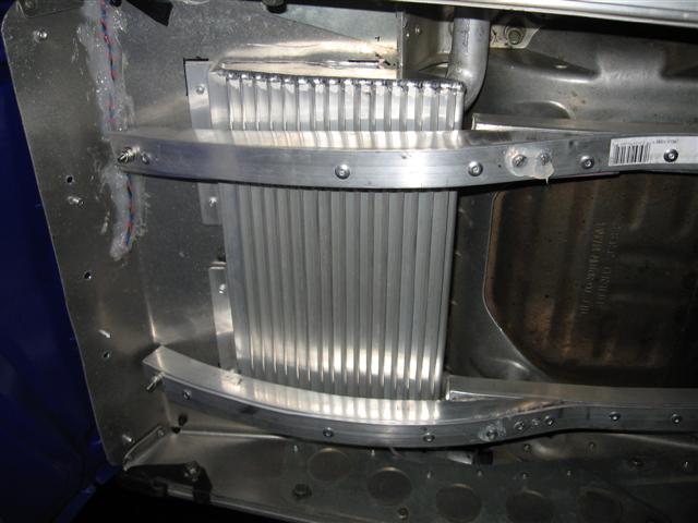

4strokelover87
Well, I finally got back to it and got the sharp edges covered up with some 1/8" aluminum. I went ahead and covered the back of the tube too to give it a more finished look...not that anyone will ever see it, but that's just how I am!!! Here is the finally finished project!!!!

4strokelover87
Sorry about the big pics....photobucket is not cooperating tonight for some reason...hmmmm....
Looks great!!!!!!!
