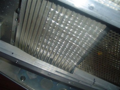

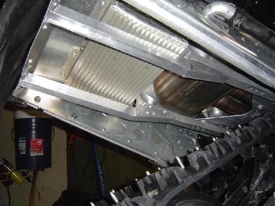

Ist-if you got air 3 out of 4 times you ran her up a bank to bleed, then you still have air in the system, only makes since, you have to replace the released air with the anti-freeze mixture. There is a fixed amount of space in the system, bleed out air and replace with anti-freeze. You can't just bleed, you must bleed and add coolant, bleed and add coolant, bleed and add coolant, got it?
2nd-absolutley add a rear heat exchanger-don't forget the tunnel protecters. There are several posts on how to construct. Very easy with some aluminum channel and flat stock and rivets. Bleed it from the elavated rear. This will solve your problem for ever.

Well, I am back to work this morning....suck!!!! Roads sucked coming home, made for a long drive. For those of you who have installed a rear cooler, what kit did you go with? I was looking at Pioneer Performance's kit. I have also heard of people using the rear cooler for an RX Mountain. What is going to be the best one to go with here? Sounds like I need to raise the rear, install my cooler, and then bleed and add coolant as necessary. I was unclear on how to properly bleed with the bleed screw in back. I didn't realize the sled was to be running while unscrewing the bolt, but that does make sense!!!
Kinger - Where do you stay on Big Saint? We stay on the west shore at Fath's Big Woods....realy great people and nice cabins!!! I'm not sure if it's the same trail you're talking about, but there is a stretch of 70 SW of Big St. Germain Lake that we hit every year, multiple times, that is just as you have described!!! Awesome!!!
Let me know which cooler I should go with and I can get the thing on order so I can get it on before we go back up in February!!! Thanks guys!!!

that is the one i have in mine. thank god for ty as dealer part's guys had never heard of the kit. really helps with the overheating problem. mine still runs warm though, it will not accumulate snow on this cooler at all or on the tunnel top either. i have ridden is a lot of powder and it is always this way.
